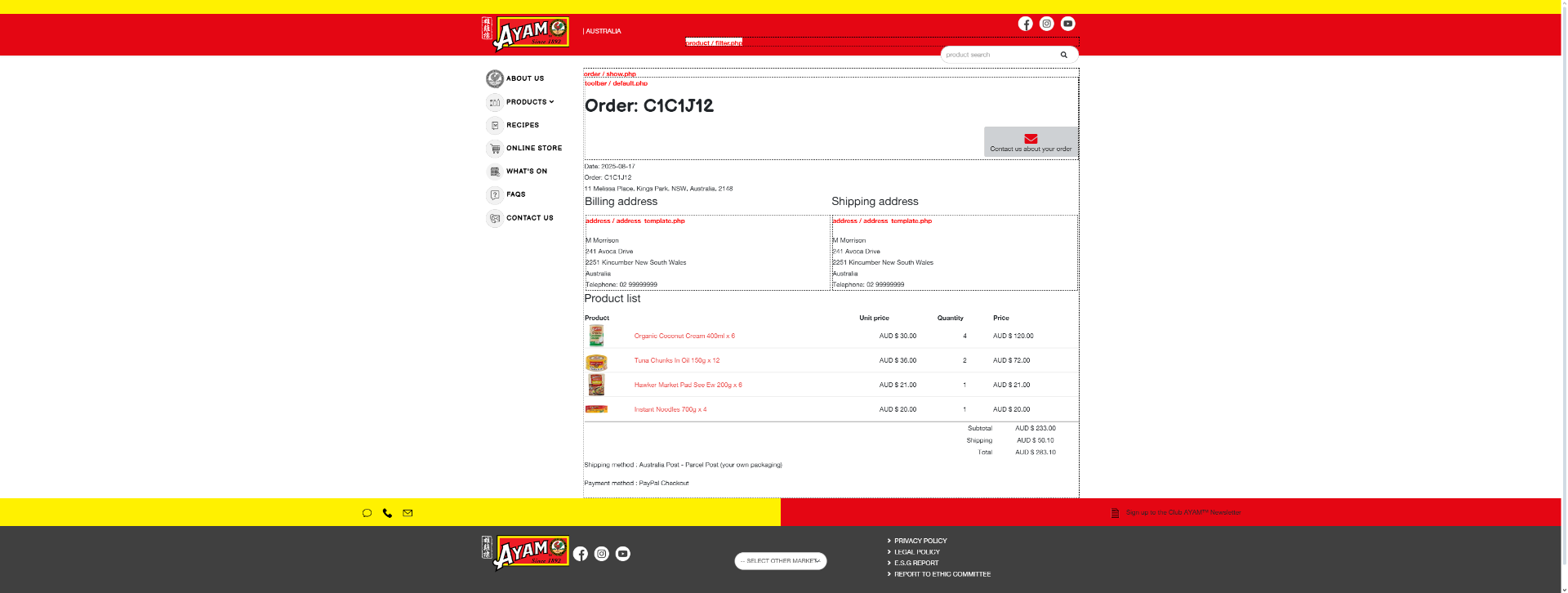

I would like to add the payment button/link on the customer order which they can view this order on user.customer control panel.
Please refer to the attachment, where the user have select the Paypal option for payment, but they don't proceed to make payment instantly.
They go back to their control panel and check back the order detail and try to make payment. Is there any way we can add the payment button on the bottom.
Thanks in advance.

Yes. Turn on the "Payment of orders not paid immediately" setting in the HikaShop configuration page:
www.hikashop.com/support/documentation/5...nfig.html#main_order
Then, the button will appear automatically as long as the status of the order is one of the enabled statuses under the "unpaid" column of the System>Order statuses menu.

Thanks. It working.
