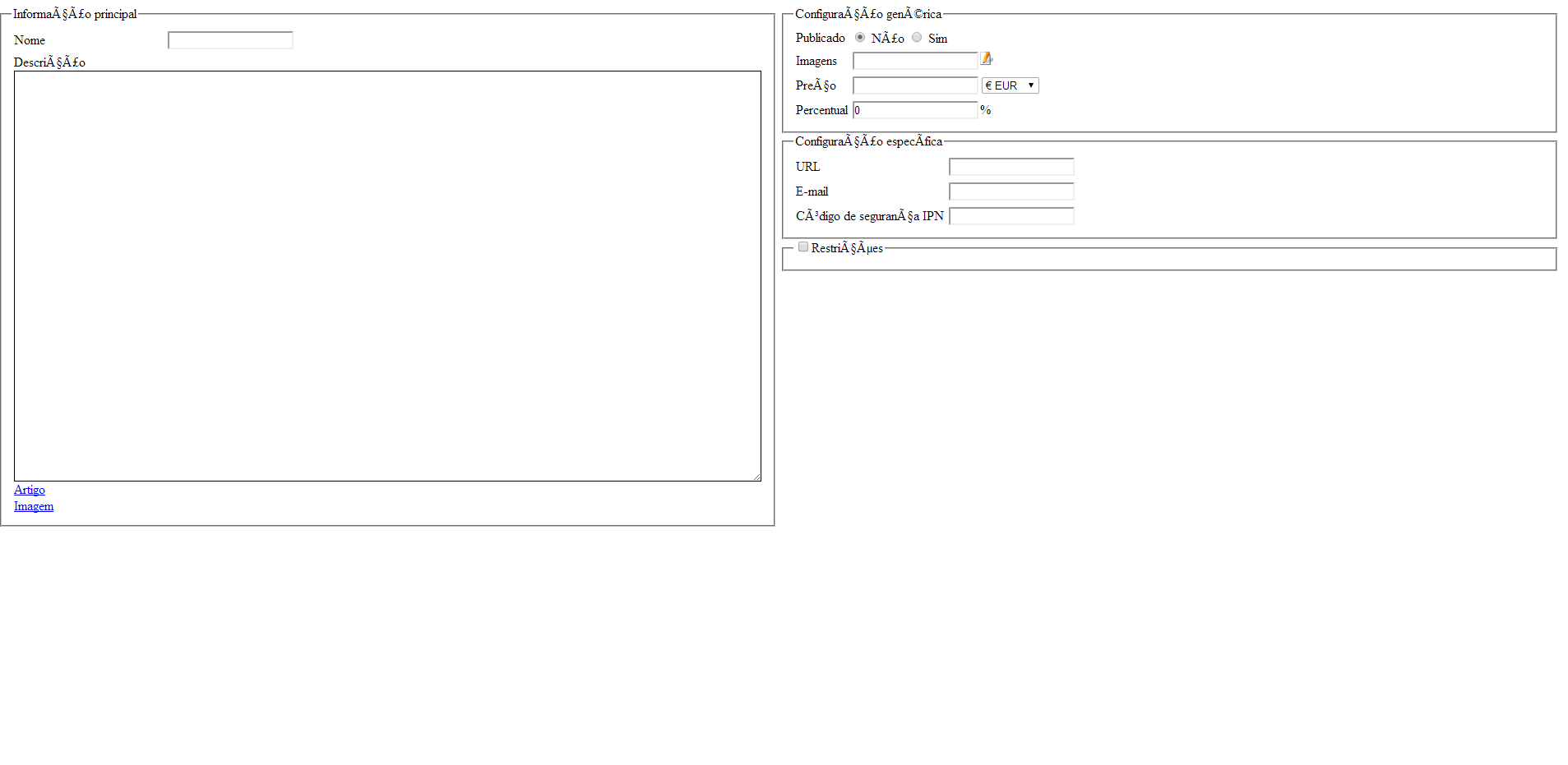

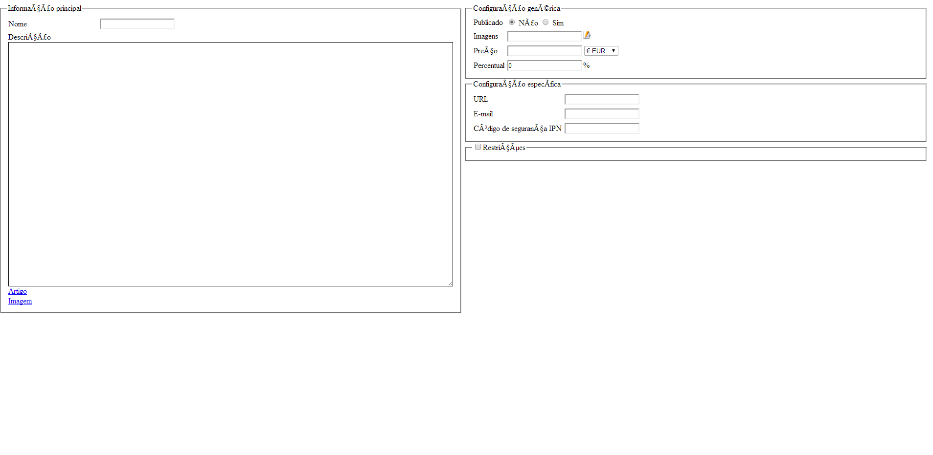

12 years 7 months ago #138998
I did exactly as you said, but the plugin configuration page stay the way as on print-screen attached. What is wrong? The font of plugin is also attached, please help!

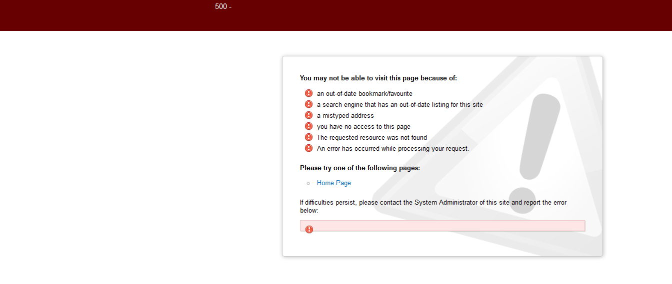

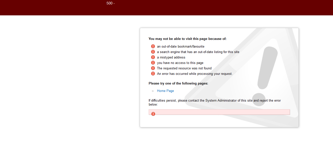

Forget my last message, i have created other plugin based other payment plugin and that error is no more.
But my new plugin get a error 500 on the step2, after finish order (the payment's library create a external link), like printscreen attached. Do you have any idea why this error?
Last edit: 12 years 7 months ago by andersondionizio.
  • Posts: 86095
  • Thank you received: 14199
12 years 7 months ago #139126
A 500 error doesn't say anything about the problem. It could be anything.
Look in your server's PHP error log for the Fatal error behind that 500 error and you will know where it's coming from and why.
