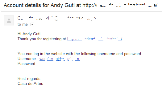

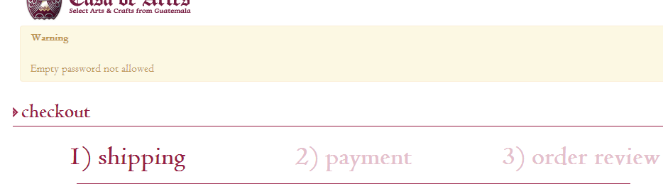

And other thing, if a guest does a checkout with the e-mail address "This email address is being protected from spambots. You need JavaScript enabled to view it.", then he can't create an account using that same address. The registration e-mail (after the checkout) comes with a blank password and a warning appears that the password is blank.

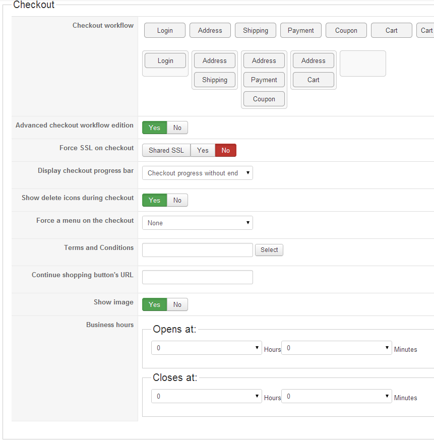

12 years 6 months ago #143725
Hi, this is the checkout configuration attached as image

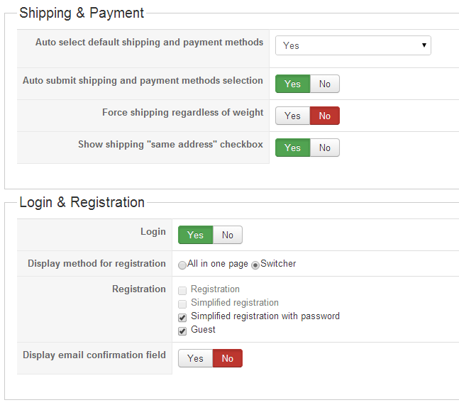

Note that you'll probably find your answer through this thread :
If you want to enable your customer to checkout without registering, you'll just have to
- Go to "Hikashop->System->Configuration->Checkout"
- Set the "Display method for registration" option to All in one page
- Set the "Registration" option to Guest
Note that the Registration / Display method for registration options are only available through an Hikashop commercial version, so YES you'll have to use a commercial version to do that :).

12 years 6 months ago #144150
Any ideas on the empty password being sent for guest checkout?
  • Posts: 86095
  • Thank you received: 14199
12 years 6 months ago #144230
Please update to HikaShop 2.3.0 and that will fix the problem. You can download it on our website via the menu Your account>Your susbcriptions.
