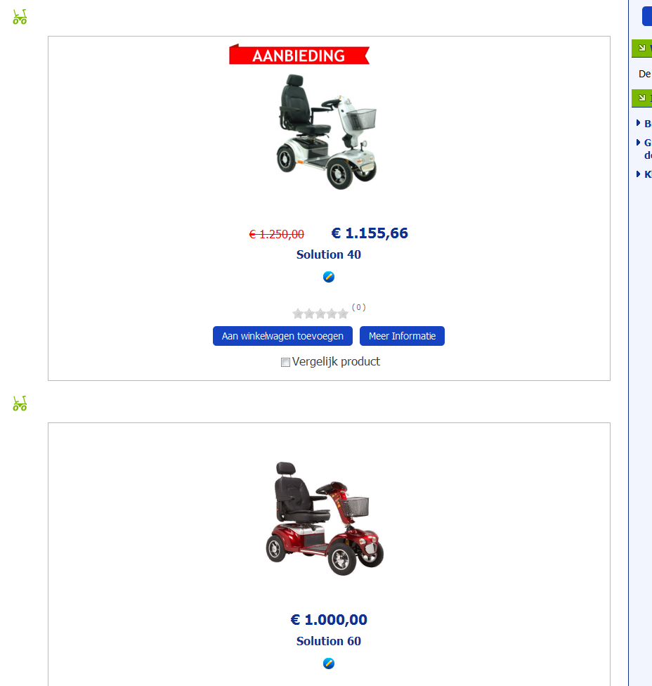

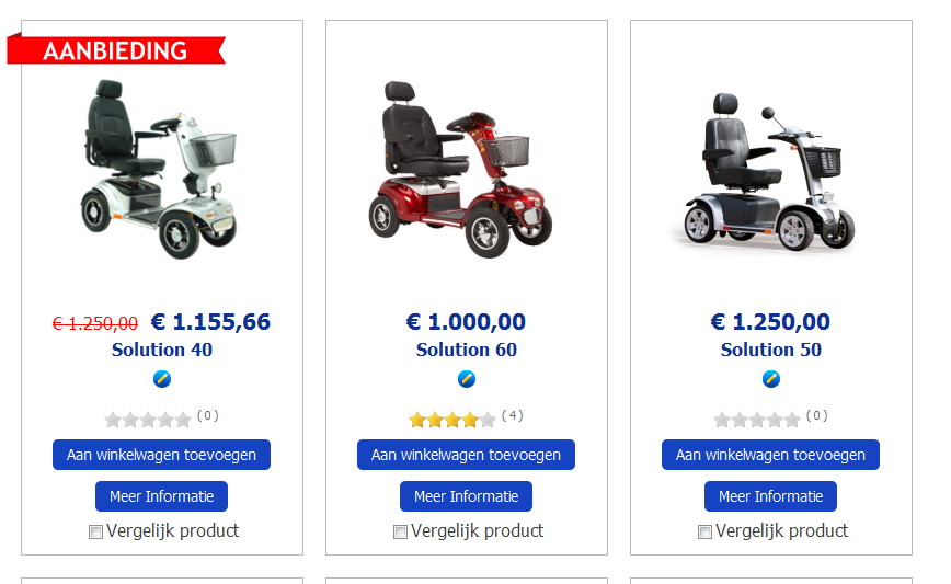

we are developing on www.01.uw-hiow-concept.nl i have attached 2 images, one is without bootstrap and one with bootstrap on desktop.
When bootstrap state on Yes we get the 1 column.
What i discovered is, that when enabling bootstrap the columns are put in a <li> tag on desktop, that is i think why we get the 1 column.
how can we adjust this so it will for mobile dvices ok but for desktop devices it shouldn't
Tnanks.
