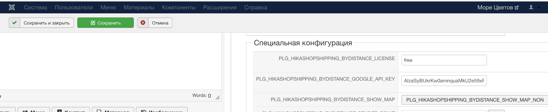

I'm developing a plugin delivery.
I want to use multilanguage in myplugin_configuration.php. The code snippet:
<td class="key">
        <label for="data[shipping][shipping_params][googleApiKey]"><?php
            echo JText::_('PLG_HIKASHOPSHIPPING_BYDISTANCE_GOOGLE_API_KEY');
            ?></label>
</td>
Created en-GB.plg_hikashopshipping_myplugin.ini and in myplugin.xml added unit:
<languages>
		<language tag="en-GB">en-GB.plg_hikashopshipping_myplugin.ini</language>
</languages>
After installing the plugin en-GB.plg_hikashopshipping_myplugin.ini appeared in /mysite/administrator/language/en-GB/en-GB.plg_hikashopshipping_myplugin.ini, but the constants are not framed on the page (screenshot).
Am I doing something not right or a multilanguage in hikashopshipping not supported?

8 years 10 months ago #276972
It didn't help. What was to change? The former option "language" in the XML file also worked, when you install the plugin file is copied to /MySite/administrator/language/EN-GB/. But the problem is that the language constants are not read from /MySite/administrator/language/EN-GB/EN-GB.plg_hikashopshipping_myplugin.ini.
By the way, exactly the same code in plugins hikashoppayment working fine!
