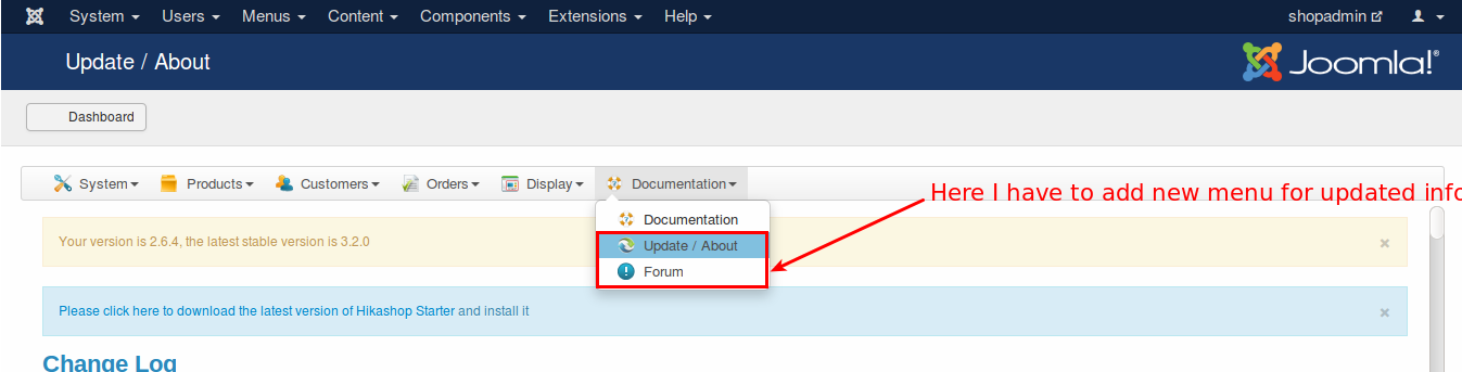

-- Joomla version -- : 3.8.0
-- PHP version -- : 5.6
How to create a menu in hikashop configuration in coding part. See the attached screenshot.
  • Posts: 86094
  • Thank you received: 14197
8 years 11 months ago #279355
You need to create a Joomla plugin of the group "hikashop", implement the onHikashopBeforeDisplayView trigger (
www.hikashop.com/support/documentation/6...hopBeforeDisplayView ), and in it, add your menu elements to $view->menus when it exists and that you're in the backend and it will work. You can do a var_dump of that variable to check the format that you need to use for your menu elements.
