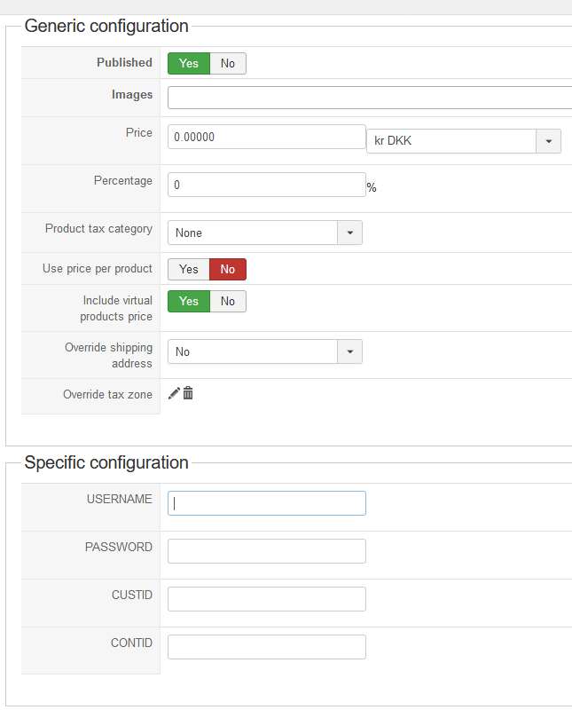

  • Posts: 8
8 years 10 months ago #280363
well yes and no... that part i have working... but within that, i need to get some of the variables defined in the screenshot attached
they have been defined like this
class plgHikaShopshippingCustom extends hikashopShippingPlugin {
	var $multiple = true;
	var $name = 'custom';
    var $doc_form = 'custom';
	var $pluginConfig = array(
		'username' => array('USERNAME', 'input'),
		'password' => array('PASSWORD', 'input'),
		'customerid' => array('CUSTID', 'input'),
		'contactid' => array('CONTID', 'input'),
so now i need to get to that info that the user admin have added in the configuration in the plugin :)
  • Posts: 86094
  • Thank you received: 14197
8 years 10 months ago #280370
So it looks like you're developing a shipping plugin.
In that case, you can use such code:
$shippingClass = hikashop_get('class.shipping');
$shipping = $shippingClass->get($view->order->order_shipping_id);
echo $shipping->shipping_params->customerid;
That will display the value you entered in the "customerid" field of the shipping method selected in the order on the order page of the backend.
