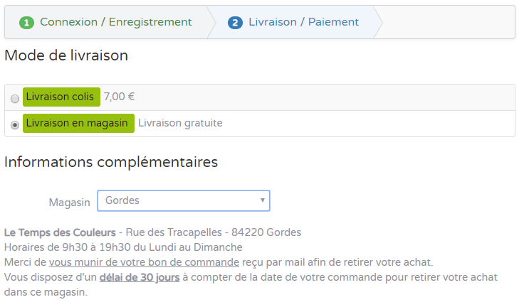

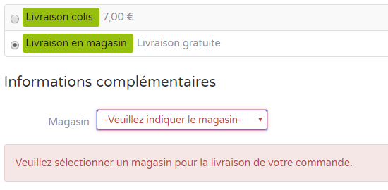

And yes, according to the value (empty or correct shop selection) i use a change event to display an alert (if empty) or display some useful information about the shop (hours, address) if it is a correct selection :
I post this code at the end oh the "Checkout >show_block_fields" file line 119

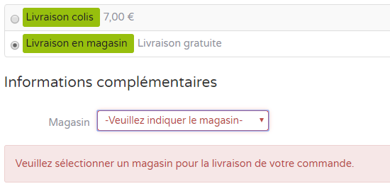

if no shop selected:
If a shop is selected, display extra infos:
Last edit: 7 years 5 months ago by garstud.
