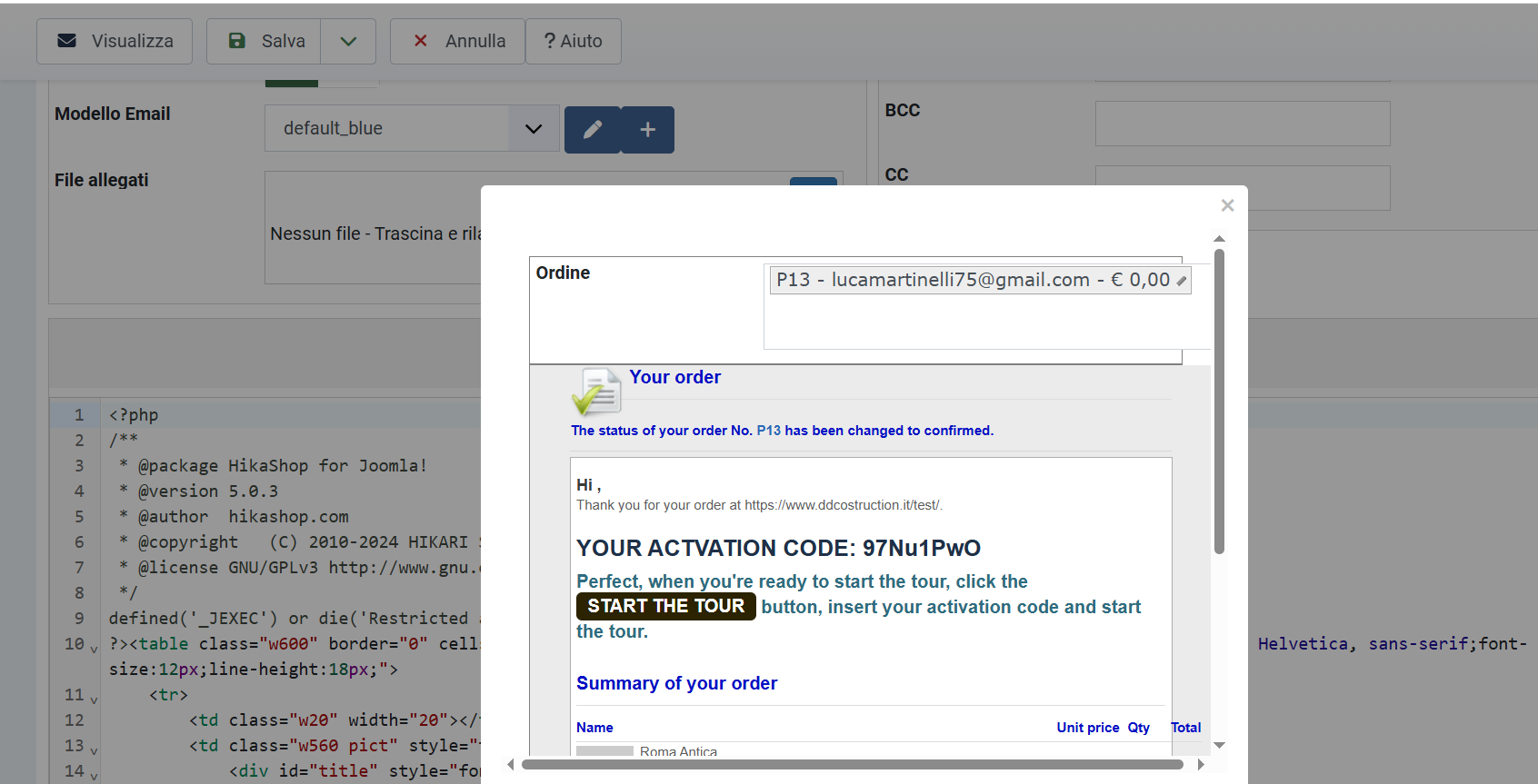

I followed your advice by inserting this code directly into html:
<p>
<h3 style="color: #00000;">ACTVATION CODE:{VAR:order.order_token}</h3>
<h4 style="color: #2e6c80;">Click the <a href=" app.tapatour.eu/ " target="_blank"><span style="background-color: #2b2301; color: #fff; display: inline-block; padding: 3px 10px; font-weight: bold; border-radius: 5px;">Activate</span></a> button to start the tour.</h4>
</p>
as you can see from image attached ...
in the backend it's working fine but not in the email confirm...

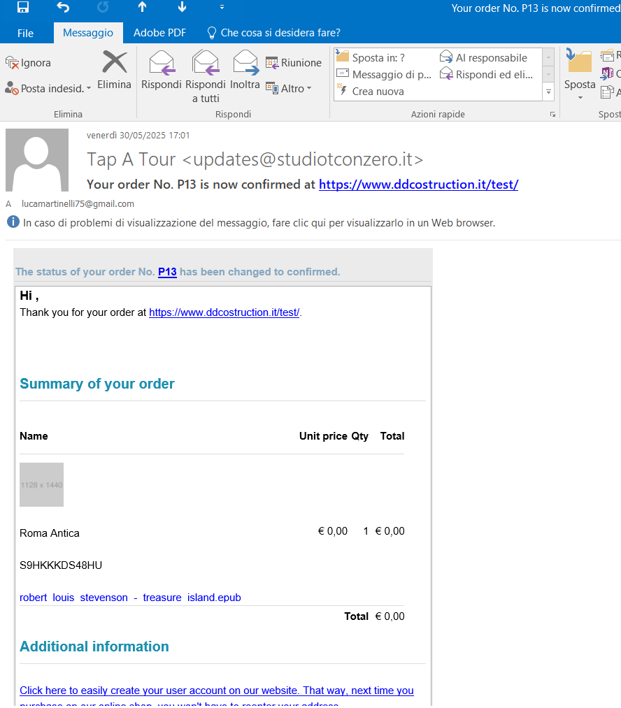

I have a doubt that I edited the wrong email :(
  • Posts: 86094
  • Thank you received: 14197
1 year 3 months ago #367401
It could indeed be that you're not editing the correct email.
Check in the Customers>Emails history menu. There, you can see all the emails generated by HikaShop (both normal ones and test ones). You can see the "type" of each email, which will tell you which email you need to edit in the System>Emails menu.
Also, it seems you want to change the "order status notification" email.
Note that when you edit this email, you have extra "per status override" buttons on the interface. This way, you can customize the email differently for different statuses.
If you have a status override for the "confirmed" status for the HTML section, the status override will take priority over the HTML section of the main area of the order status notification email.
So it could be that you previously made a customization of the HTML section for that status, and now that you're making a change in the main HTML section, you don't see the changes because of the HTML section for that status is being used.
And when you use the preview button, it's not exactly the same process used to generate the email (because the status of the order is not really being changed) so you don't see the problem there.
Note that this is just a potentiality. I'm not saying that this is the problem you have here.

  • Posts: 9
1 year 3 months ago #367408
ok, perfect NIkolas...
now works perfectly.
i was actually editing the wrong email (lol!) :)
sorry if i'm wasting your time but i'm just now starting to understand how it works.
Anyway yes, I would like to edit the confirmation email of the successful (paid) order where insert the {VAR:order.order_token} and the instructions that then the customer will use in the progressive webApp to activate the tour/service...
