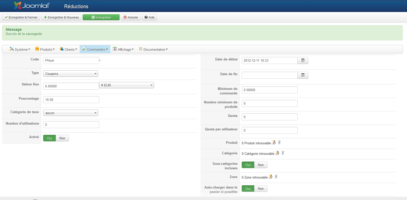

1. You'll be able to create your coupon through "Hikashop->Orders->Discounts->New" by setting the "Type" option to Coupons, and your coupon's code through the "code" option.

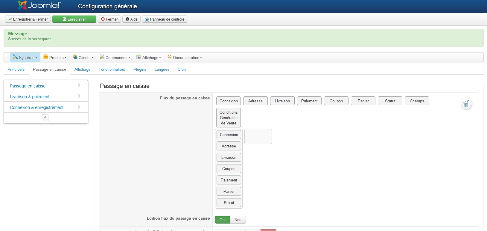

2. As I told you, if you want the coupon code input to be displayed through your checkout :
You'll just have to add the "coupon" action through one of your checkout workflow step via "Hikashop->System->Configuration->Checkout".

<> I have implemented a coupon (code "PNoel" for 10% discount, see enclosed image "parametrage_coupon.jpg")
<> The coupon step is included in the workflow (see enclosed image "parametrage-passage-en-caisse.jpg")

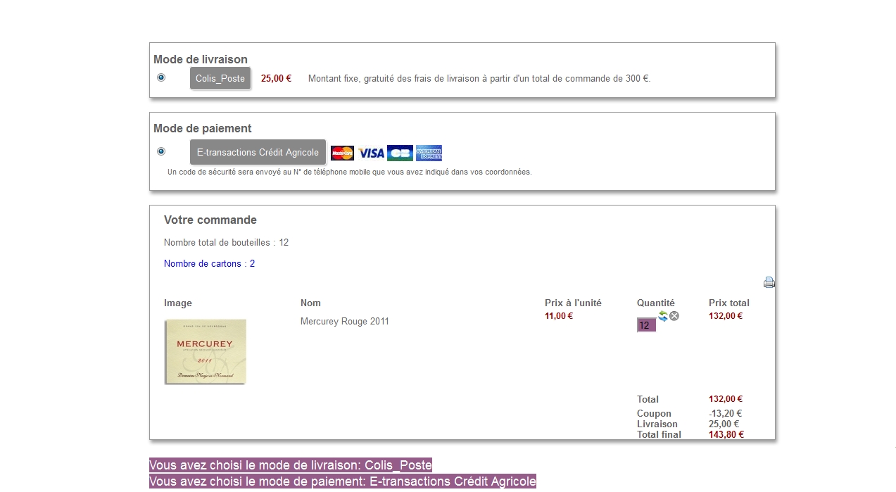

<> In the front-end the 10% discount is automatically calculated, there's no input zone for typing the coupon code (see enclosed image "check-out-front-end.jpg")
I must have missed something somewhere ...
