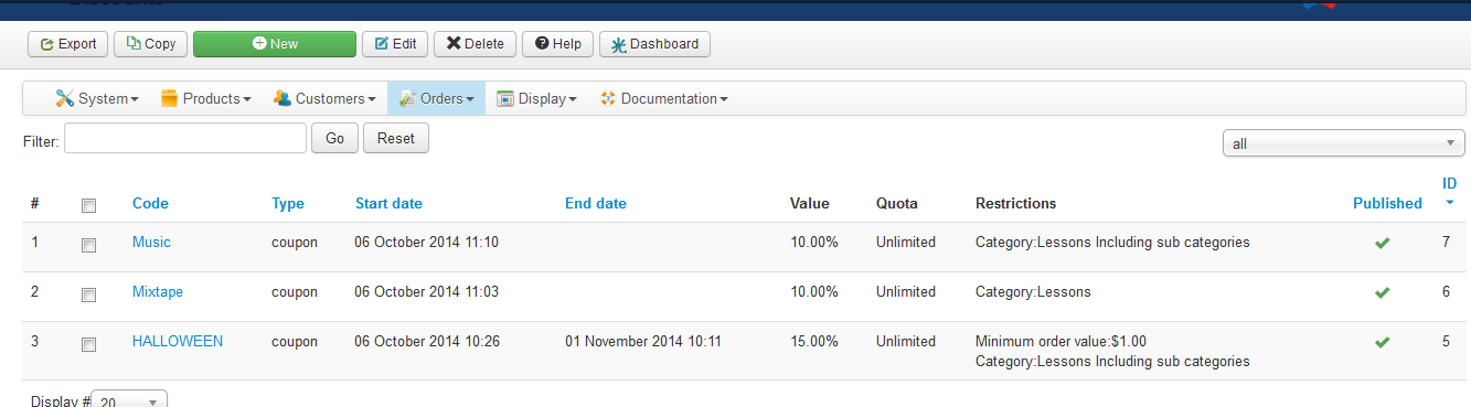

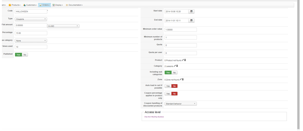

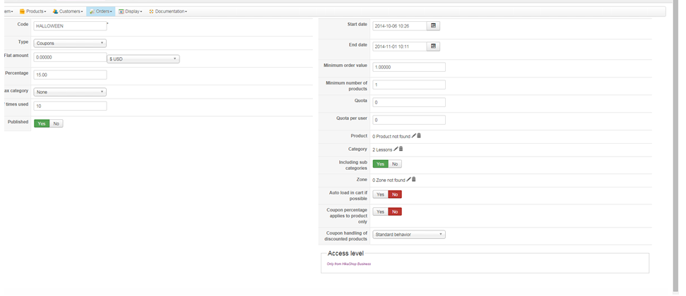

11 years 10 months ago #174593
Please give us a screenshot of you coupons in the menu Orders > Discounts.
  • Posts: 48
11 years 10 months ago #174691
Here it is:

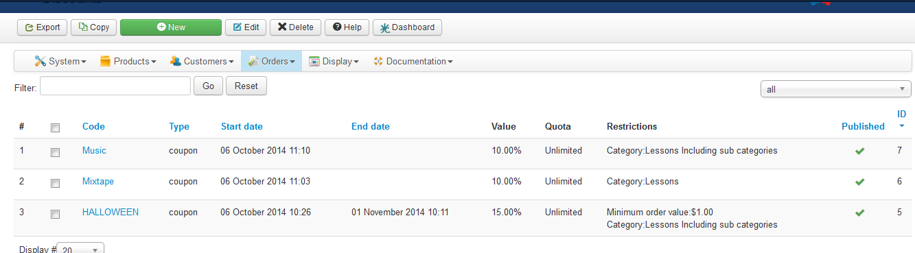

  • Posts: 48
11 years 10 months ago #174706
Maybe this is better:

11 years 10 months ago #174889
Coupons can only be entered during the checkout.
Creating a custom field on the product page won't make the system process the coupon.
So it's normal that it doesn't work.

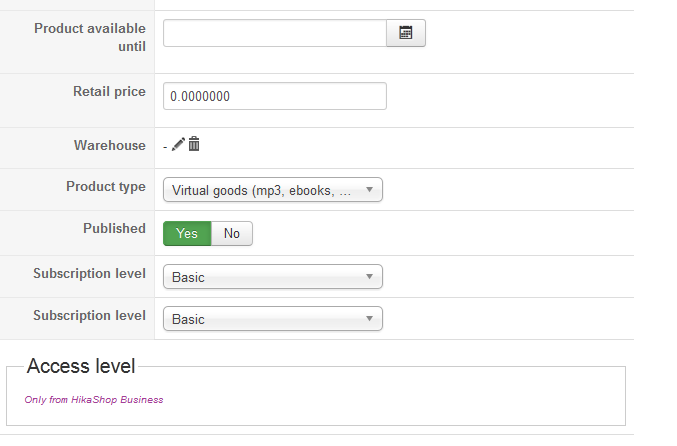

Here's a screenshot of the product information in Hikashop. Note that there are TWO select boxes for subscription.

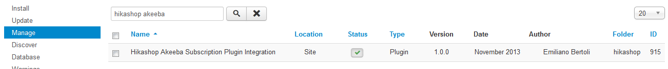

  • Posts: 48
11 years 10 months ago #175601
Nic-
I re-installed the 1st Akeebasubs hikashop plugin.Still the same problem. Here's a screenshot.
  • Posts: 86077
  • Thank you received: 14184
11 years 10 months ago #175626
"Emiliano Bertoli" is the author of the second Akeeba Subscriptions HikaShop plugin which supports coupons from Akeeba Subscriptions.
So you're not using the first one. The first integration plugin available on www.hikashop.com/support/support/documen...a-subscriptions.html has the author "Hikashop".
That second plugin you have on your screenshot should be disabled.

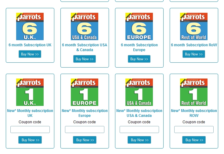

  • Posts: 7

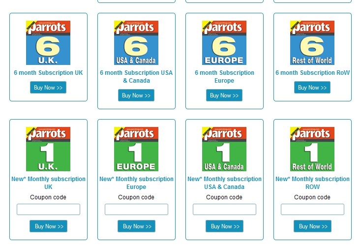

11 years 6 months ago #190608
This is the screenshot, the top subscriptions are non recurring hikashop products, the bottom subscriptions are hikashop products linked to akeeba subscriptions and PayPal recurring payments.
Emerald is no good for us it's Joomla 3 only and the site is 2.5.

11 years 6 months ago #191614
The coupon field on your screenshot is not a coupon field. It's a custom item field that you created with the label "coupon".
Disable it via the menu Display>Custom fields if you don't want to display it.
