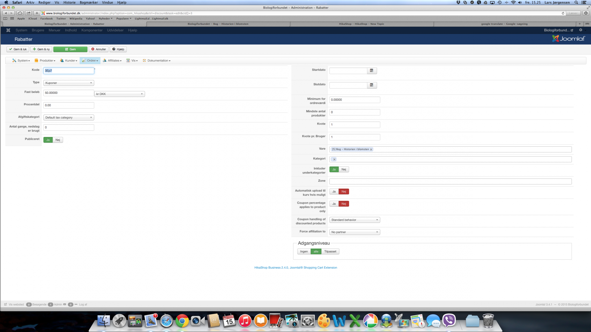

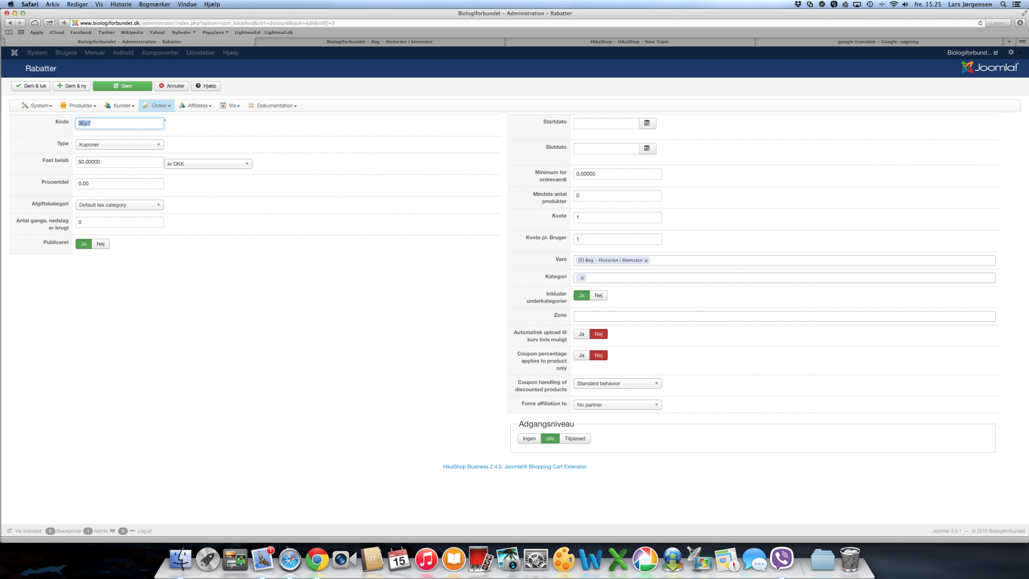

I bought Hika Shop on May 12, 2015 , but I have trouble creating a coupon code for a single product. I get this error: This coupon can not be used for the products in the basket , and finally I get this error message:
Warning: explode() expects parameter 2 to be string, array given in /home/www/biologiforbundet.dk/administrator/components/com_hikashop/classes/discount.php on line 223
The coupon Code is 3Ep7 and the product is ( www.biologiforbundet.dk/index.php/salg/h...historien-i-blomsten )
Can you please help me
Best regards
Lars
PS. Cupon code works fine if I put it into a category / and i have already tried to update Hika Shop

Please edit the file "administrator/components/com_hikashop/classes/discount.php" and replace line 222
if (!empty($coupon->discount_product_id)) {
By
if (!empty($coupon->discount_product_id) && is_string($coupon->discount_product_id)) {
It will fix the warning and should improve the discount on the product.
But I see in your configuration that you have also a category selected but without a name ; please be sure that this category is removed from the discount configuration ; it might also affect the coupon processing.
