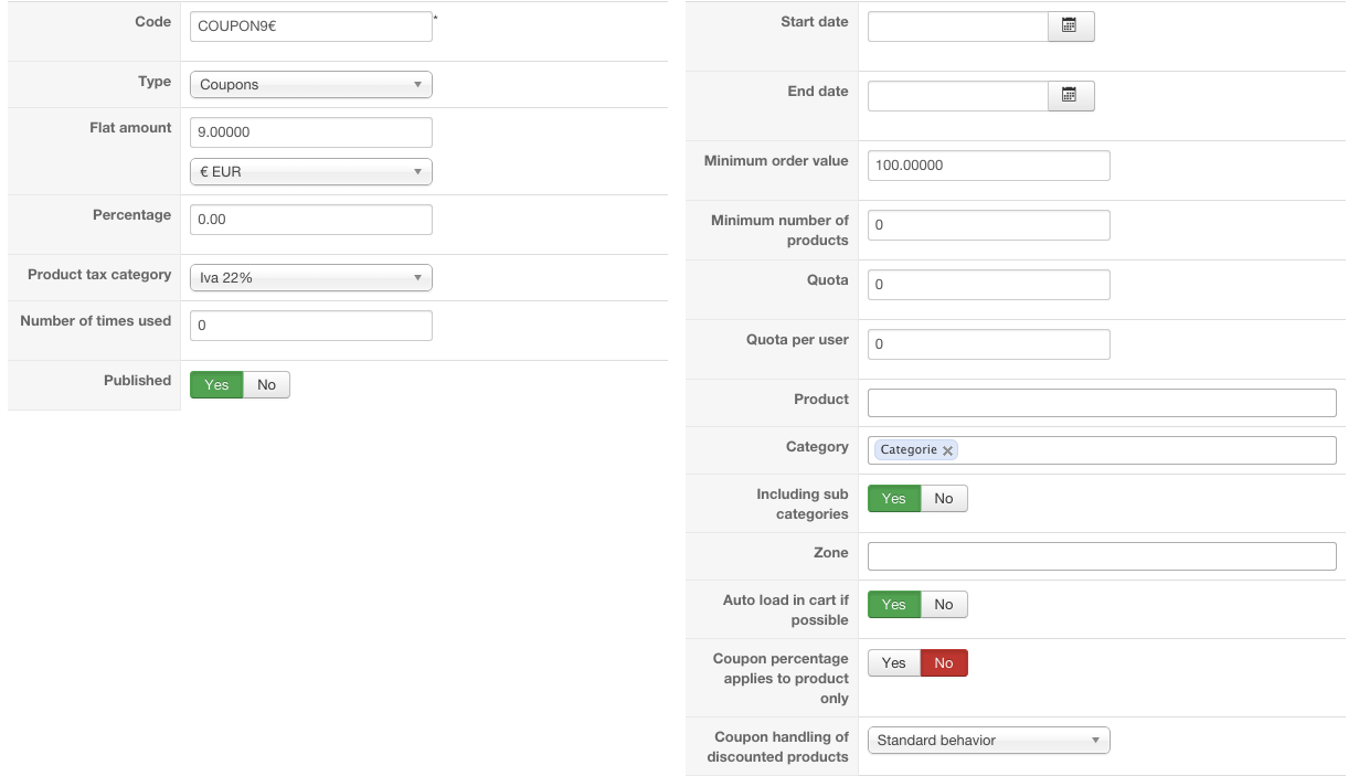

I have a problem whit coupon.
As you can see in attachment I set flat amount coupon auto load in cart.
The coupon has Minimum order value= 100€ but it's applied also for inferiors amounts.
I really don't know how to let it work properly.

I just tested it on my end and it worked fine, so can you give me more information, like how did you configured the products that were on your cart ?

I tried a lot of combinations and now it works.
I don't know the logic but it started to work when I left empty category value in discount page.
Does it work good in both case for you?

It's probably comes from the fact that your coupon was configured in a way that it would take into account the price without taxes of your products, and that your product price without taxes would be just below 100 but above 100 if with taxes. And thus you tought that it didn't work.
