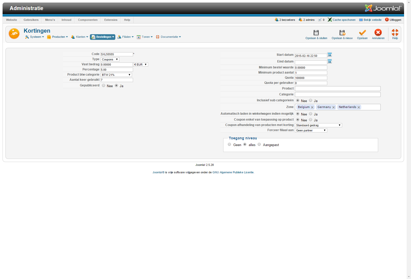

-- Error-message(debug-mod must be tuned on) -- : After adding a coupon code the shippingcosts are added
When an order is ready and more than € 100,- no shipping costs are required. But as soon as we add a coupon code like SXL55555, shippingcosts are added to the order.

11 years 3 weeks ago #204493
Please enable the option "Coupon percentage applies to product only" in the coupon settings.

  • Posts: 235
  • Thank you received: 4
11 years 3 weeks ago #204560
Yeah! That's it.
Thanks a lot!
