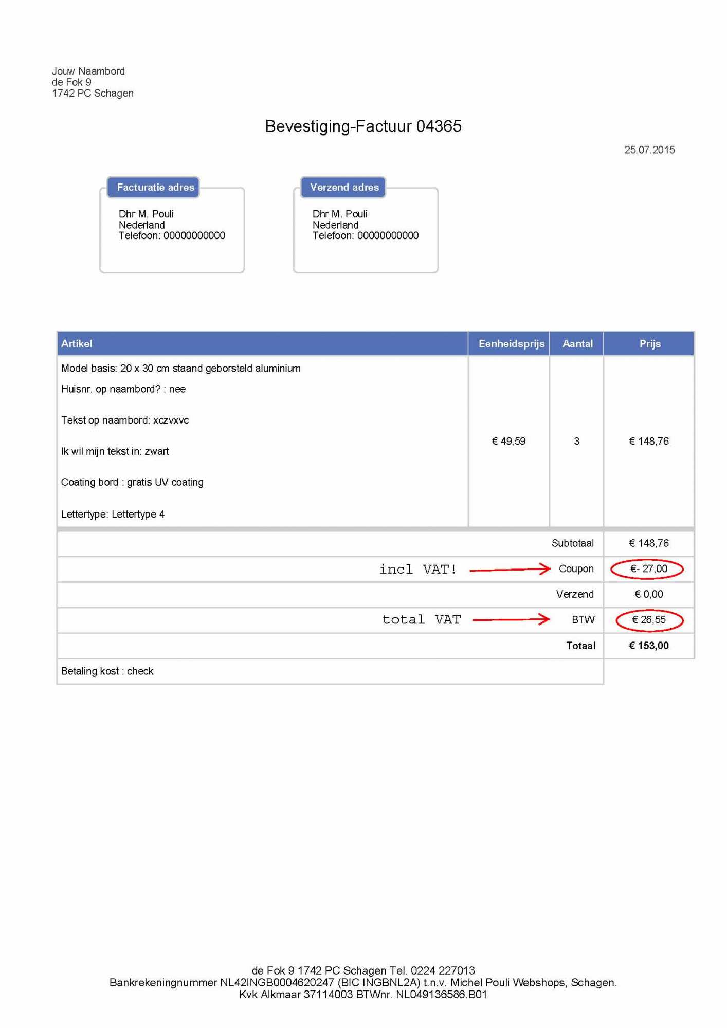

-- Joomla version -- : 3.4.3
-- Error-message(debug-mod must be tuned on) -- : strange behavior discountprice on invoice
On the invoice (plugin) the discountprice showes a price with VAT, but the VAT that is added in the next line is the total VAT. So, when you extract the discount from the subtotal and then add the total VAT the sum of this is not correcct. This is very confusing.

Well, that's not quite the way it should behave too, but it's better than the plugin. A better way to set up the invoice would be:
productprice(s) without VAT
subtotal
couponprice without VAT
total VAT (product plus coupon)
Total
I think that would be the most consistent way to handle an invoice. As far as I know this standard invoice-layout is used in most countries.
