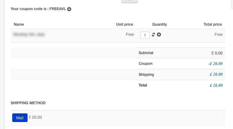

Well, not quite. This is what the checkout cart looks like:
I'm having difficulties explaining this. Can you? :whistle:

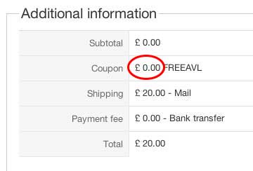

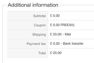

BTW, after clicking "Finish" in checkout, this is what the "bottom line" part of the order then looks like in the backend:
Coupon code = yes, Coupon value (-20) = no, math correct, but a value got lost, so the result is still wrong... :(

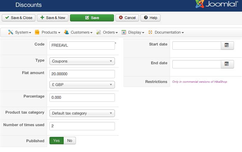

Since you might ask for it: coupon config here attached.

It seems like the coupon isn't applied on the shipping price, can you :
- Set a different value through the "Apply discounts" option via "Hikashop->System->Configuration->Main"
- Check that you don't have the "Coupon percentage applies to product only" option set to YES through your coupon configuration page.
and test it again ?

Mohamed Thelji wrote: - Check that you don't have the "Coupon percentage applies to product only" option set to YES through your coupon configuration page.
I don't understand... I had said I'm using the Starter edition, so I do not have this or other restrictions, of course. Also, I am using a fixed rate discount coupon and not a percentage, as well described in words and screenshot.

As you said coupons only apply to products.
If the sum of the product prices + coupon is below 0, the total is brought back to 0 before the shipping is calculated and added to it.

But how do you explain what's happening in the backend? I had posted the screenshot already, but here it is again, showing that the coupon value gets somehow "lost"... it's set to 0.00 there:
There seems to be more happening in the system than only the total being brought back to 0 as you say, because only this wouldn't erase the coupon value, or?

Upon further investigation, I see that for an order entered in the frontend with conditions set as above, in the database the field order_discount_code does contain the coupon name, but the field order_discount_price is 0.00000, strangely. That can't be right, no matter what you said about the condition of "the total brought back to 0"?!
Additionally, if I enter a new order in the backend with same conditions (product price = 0, shipping method/price = 20) and apply a coupon there (it doesn't recognize existing coupons, but I can enter "20" as value), it all goes well, and the math is right, means the total is 0.
And then it's also all saved properly in #__hikashop_order.
This "strange behaviour" with coupon value being saved as 0 when entered in the frontend, plus the math working in the backend, makes me wonder if there is something, or something else, going "wrong" in the system, not depending on the condition to bring the total of product and coupon back to 0.

It's normal that the coupon value is 0 in the order. The coupon value in the order is the real value that was calculated and used.
Being able to set what you want in the order in the backend is something different than the rules that apply automatically on the frontend. For example, you can easily add a product with a price of 1, a tax amount of 2 and a tax rate of 20% in an order in the backend. It's obviously wrong, but the system will let you do it. That's because the rules which apply on the frontend so that the system behaves properly are not applied in the backend so that it lets you do as much as possible corrections in orders in order to deal with special cases when the customer calls you for whatever reason and that you have to rectify whatever is needed.
