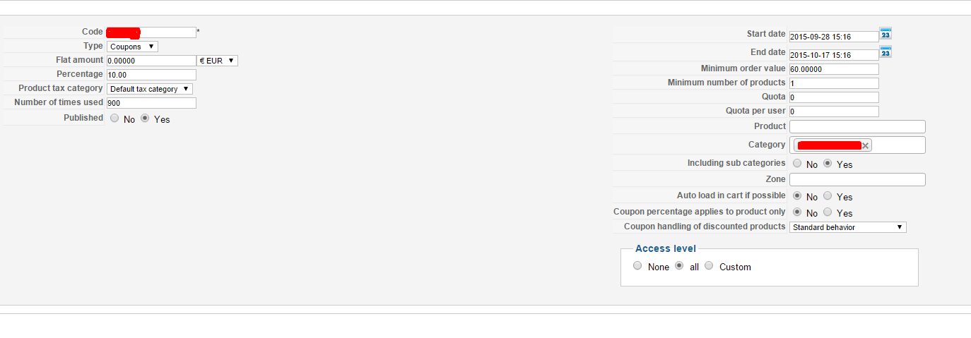

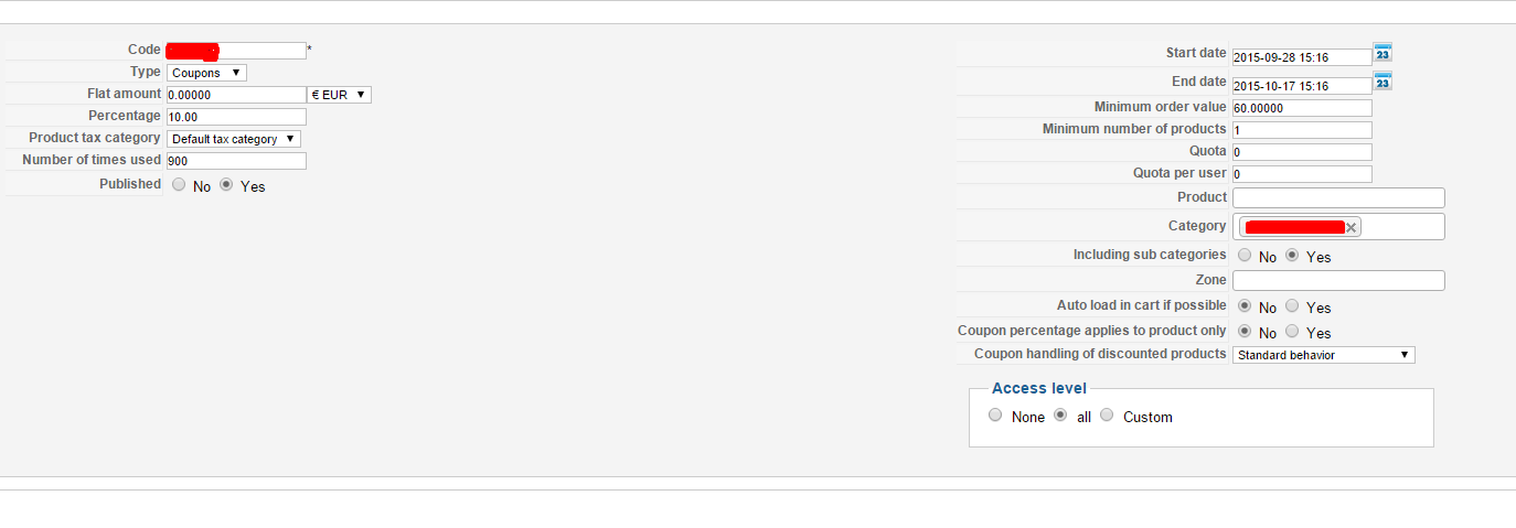

1. The coupon code you entered on your checkout is different than the one you have configured in your coupon settings.
2. The coupon is unpublished
3. The coupon type is set to "discount" instead of "coupon".
4. The coupon has been deleted.
1. Which coupon settings? In general configuration I can't found something about it.
2. See screenshot
3. Yes, it's coupon, see screenshot
4. The coupon exist, see screenshot
Then tell me what are next steps to check? Why it don't works? 1 Year agou we used over 2000 coupons... is number of coupons unlimited?

You removed the coupon code from your screenshot, and you removed as well the category for which it applies, so I can't try to test it on your website.
