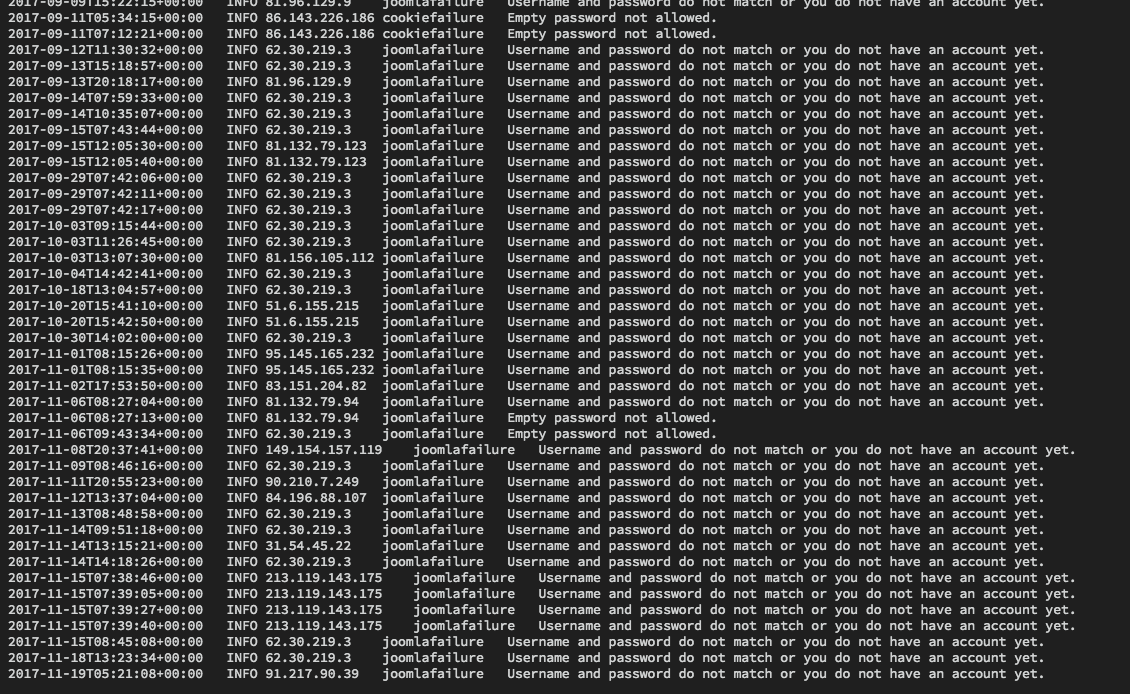

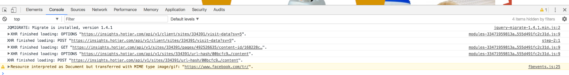

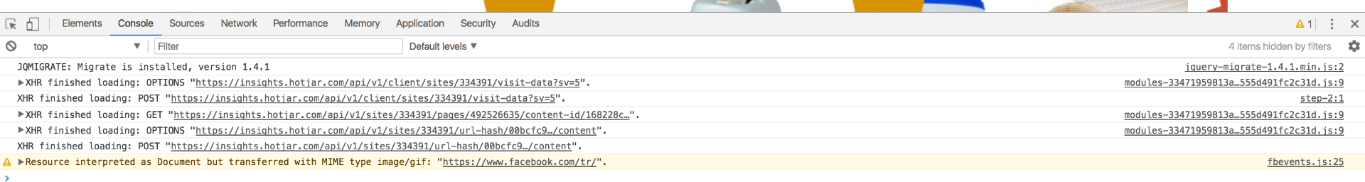

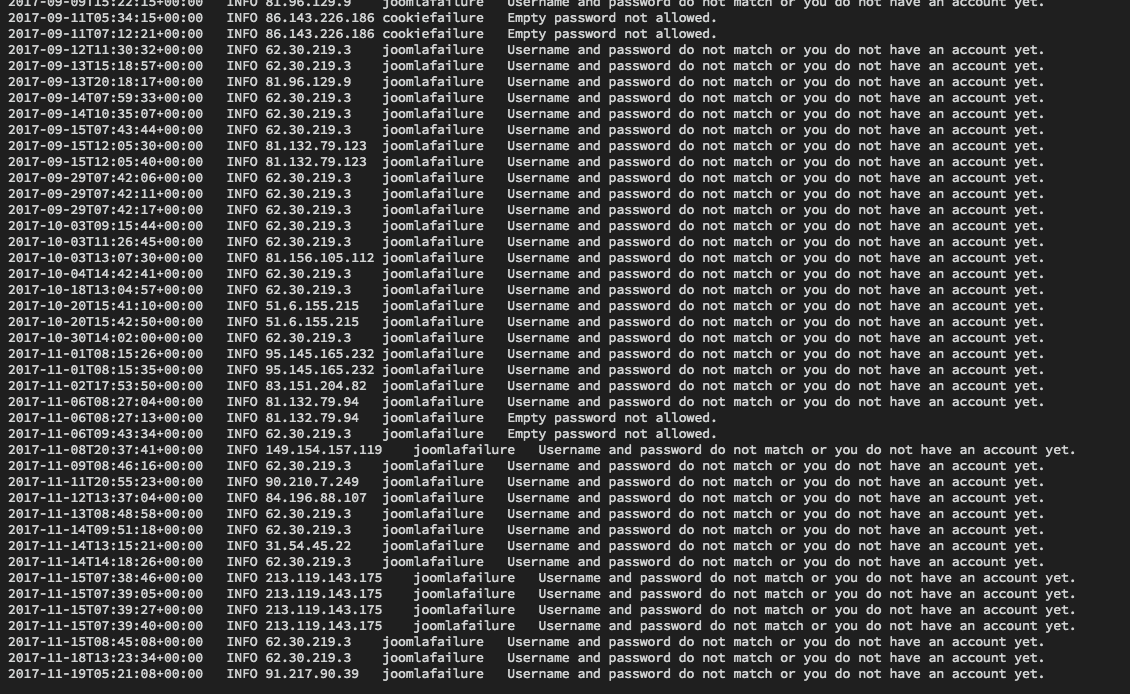

  • Posts: 256
8 years 9 months ago #282863
I am using the standard hikashop coupon system. I tried turning legacy mode off makes no difference. I have checked the logs and I cant see anything relating to the coupon. I get a warning error in the console when I press add on the coupon button. Not sure what it means.
I have attached both below:
