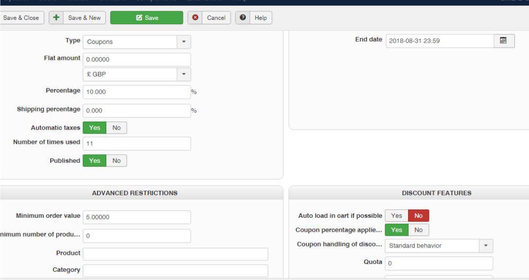

I've got a coupon set up to give 10% discount

I have tried with automatic taxes = yes, and with automatic taxes as no. Nothing has changed.

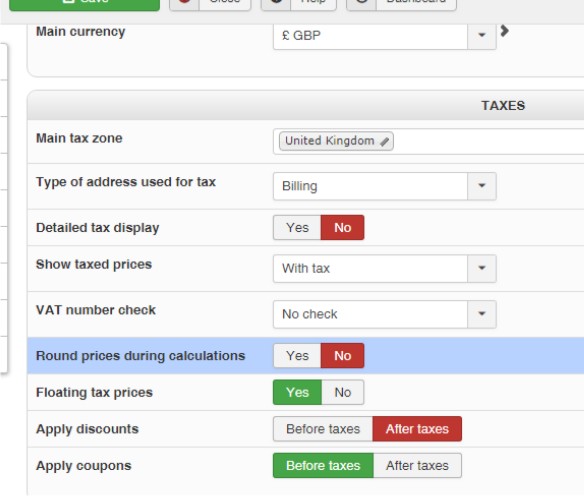

My taxes are set to apply discounts and coupons = after taxes

Please provide more details (screenshots) of how the product is configured, how the shipping method is configured (since shipping can have taxes too).
Note also that changing the "apply coupon" setting might help in the way the taxes are calculated in regards to coupons.

I managed to fix the actual percentage value by applying to product.
However, the VAT calculation is still incorrect. I have used both "before taxes" and "after taxes".
I'm sure I've just misconfigured something, I just can't see what, so I hope you can help.

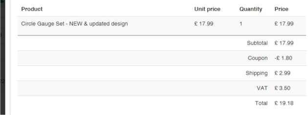

Screenshots attached. - the last being the VAT calculation on the invoice, which should be £3.20

Thanks. So the 3.50 VAT corresponds to the VAT for the subtotal + the shipping => 17.99 + 2.99 = 20.98 => 20% of VAT for 20.98 is 3.50
This means that the coupon doesn't modify the VAT amount.
I suppose that it's because you have the "floating tax prices" setting which render the calculations more complex and lead to corner cases that we didn't anticipated.
I spent several hours on the problem and was able to find out a few issues with that kind of setup. I've added patches for them, tested them, and generated new packages with the fixes included.
So download again the install package on our website and install it on yours and that should help.

  • Posts: 94
8 years 3 weeks ago #297253
Thank you.
I had changed 'apply coupon' to 'after taxes' when checking before and left it that way - and it did not work - going back to my screenshot below (before taxes) it now seems to be working as it should.
