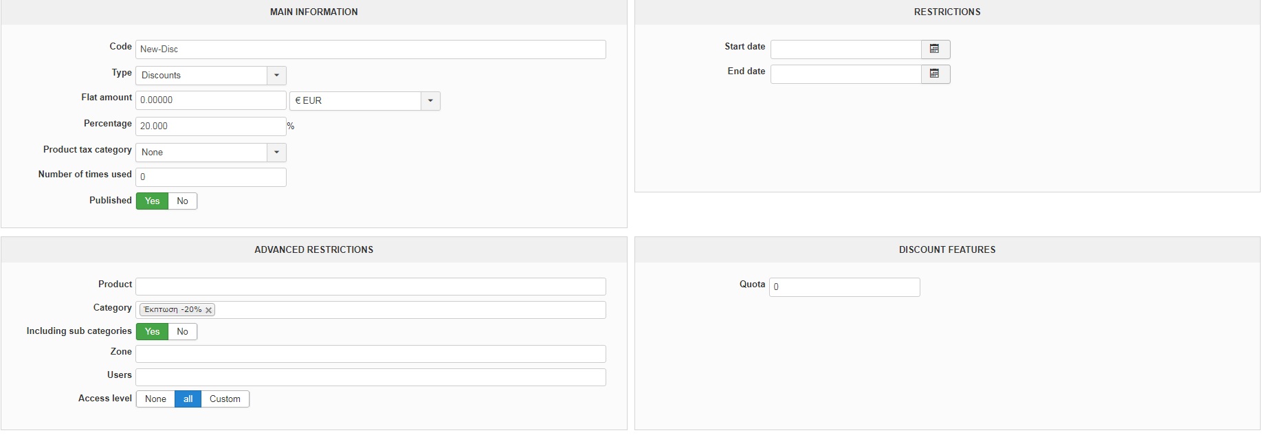

7 years 2 months ago #310303
by Giscard
Replied by Giscard on topic Discount Unpublished Category
Here is the discount.
Thank you in advance.
