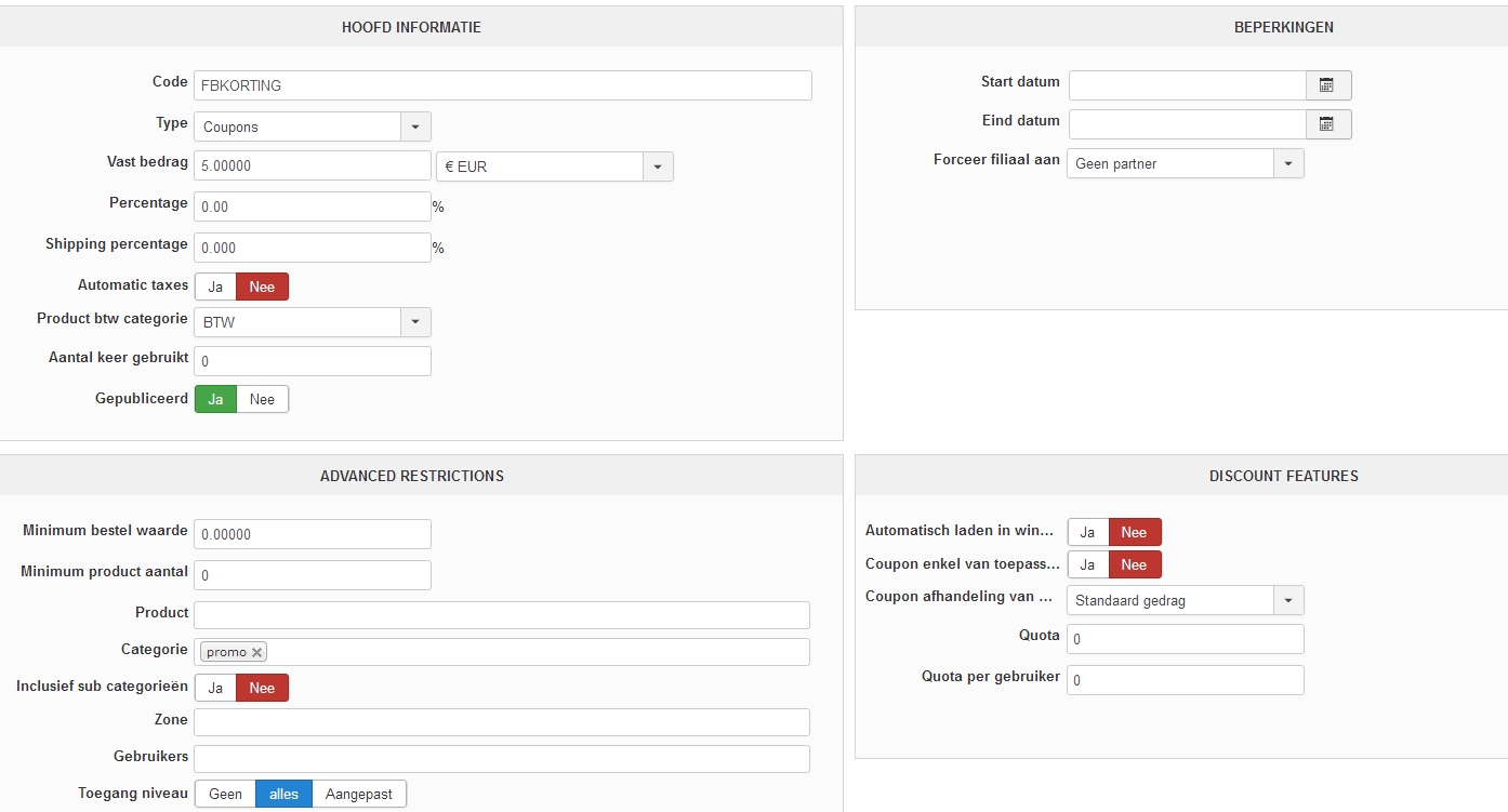

6 years 2 months ago #323171
by jivjivjiv
Replied by jivjivjiv on topic coupons no longer work
Hi Mohamed,
Screenshot attached. With that configuration I get 5 euro discount no matter how many products I buy.
I would like to see 10 euro discount if I buy two products.

6 years 2 months ago #323180
by nicolas
Replied by nicolas on topic coupons no longer work
The coupon is for the whole cart. Once one product of the "promo" category is in the cart, the coupon can be used and it will get the 5€ you configured regardless of how much products are in the cart.
You can use the "percentage" setting if you want the value of the coupon to be based on the products in the cart.
And you can activate the "coupon percentage only for products in category" setting if you want to restrict that to only the products of the category you selected to be taken into account.
If you want to have 5€ per products in that category, that would require either:
- the use of AWOCoupon pro which has more advanced rules for coupons you can use on the Hikashop checkout
- the development of a custom plugin to dynamically calculate the value of the coupon
