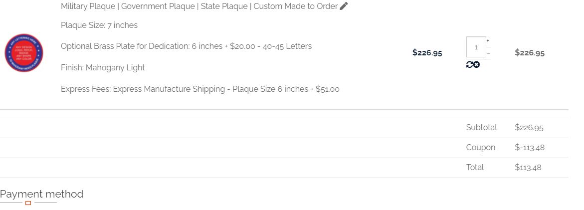

Our store calculates final price based on attributes chosen. That is size, etc. One attribute is the express shipment. The problem we face is that coupon discount should only be given against the product and not the express shipping fee.
Can we exclude the attribute "express shipping fee" from the coupon discount calculation?

Tried what you suggested.
But the discount code will be applied to the total price(product price + attributes price).
What we want for the coupon is to be deducted from the product price.

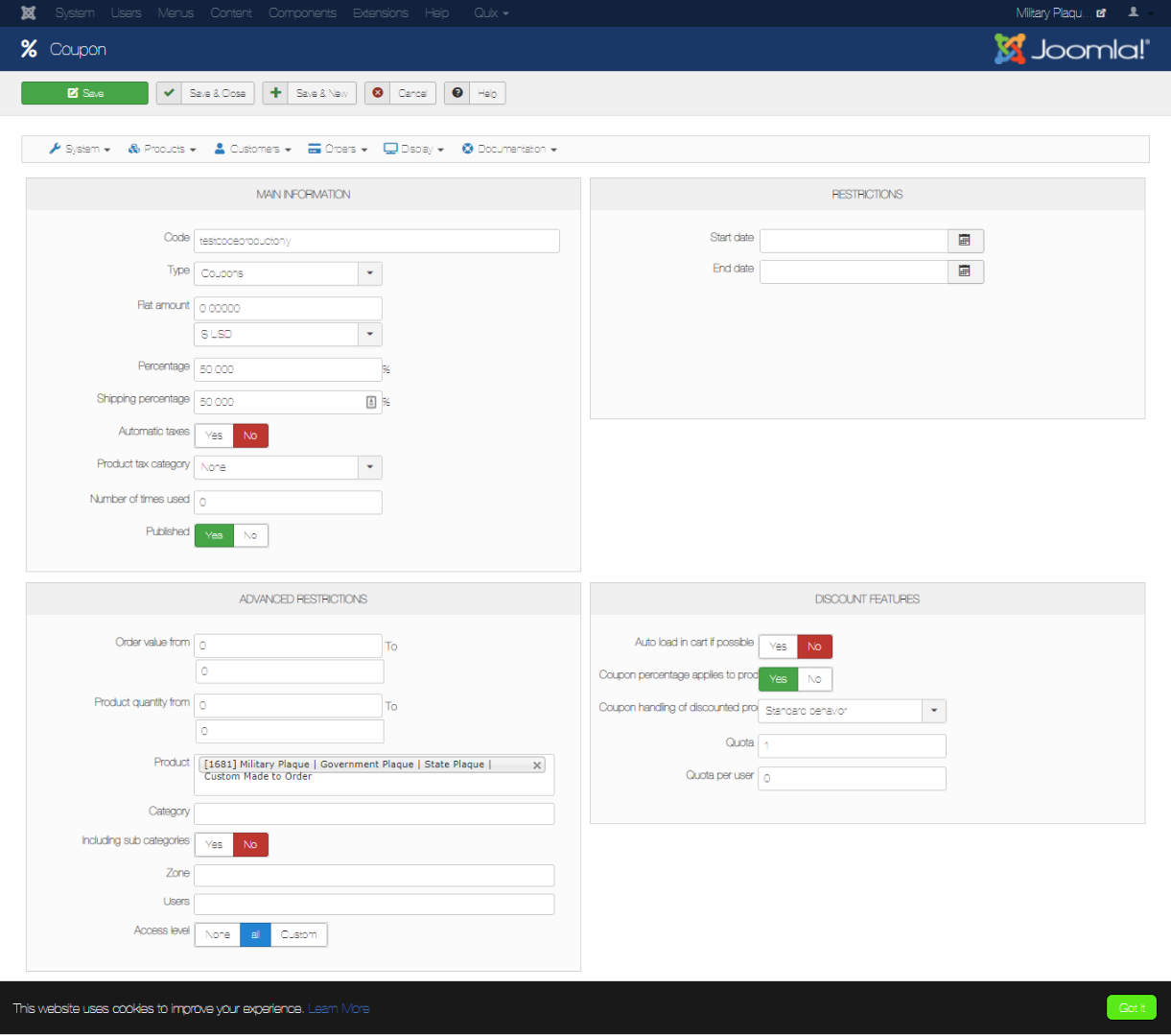

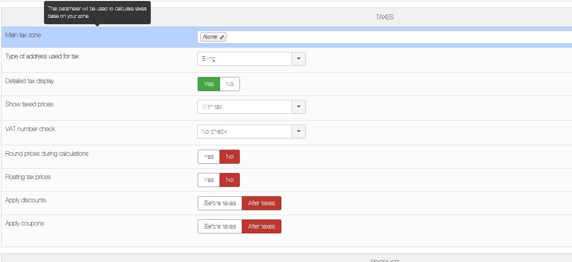

in order to netter help you, we will need to better understand the context (and check that everything work as expected) and so, can you provide these elements :
- Your coupon settings screenshot
- Your taxes part screenshot (in your Main tab HikaShop configuration)
Awaiting your element to progress on your subject.

Please see screenshots.
Attached sample product.
The original price is 155.95
Thanks.

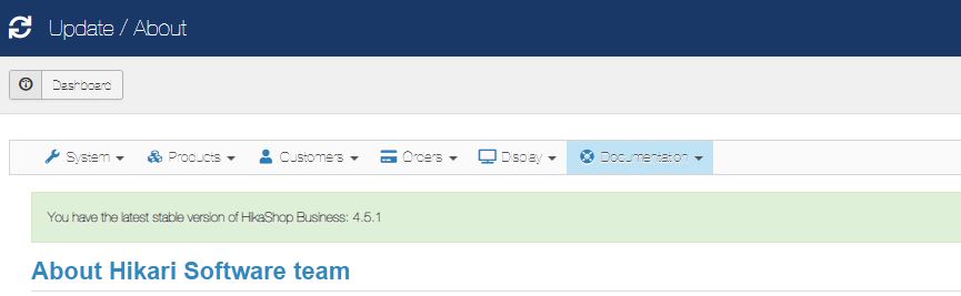

Are you really using HikaShop 4.5.1 ?
Otherwise, updating would probably help.
  • Posts: 39
  • Thank you received: 4
4 years 3 months ago #341806
Are you really using HikaShop 4.5.1 ? - Yes, using Hikashop 4.5.1
