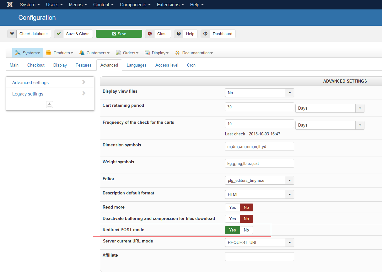

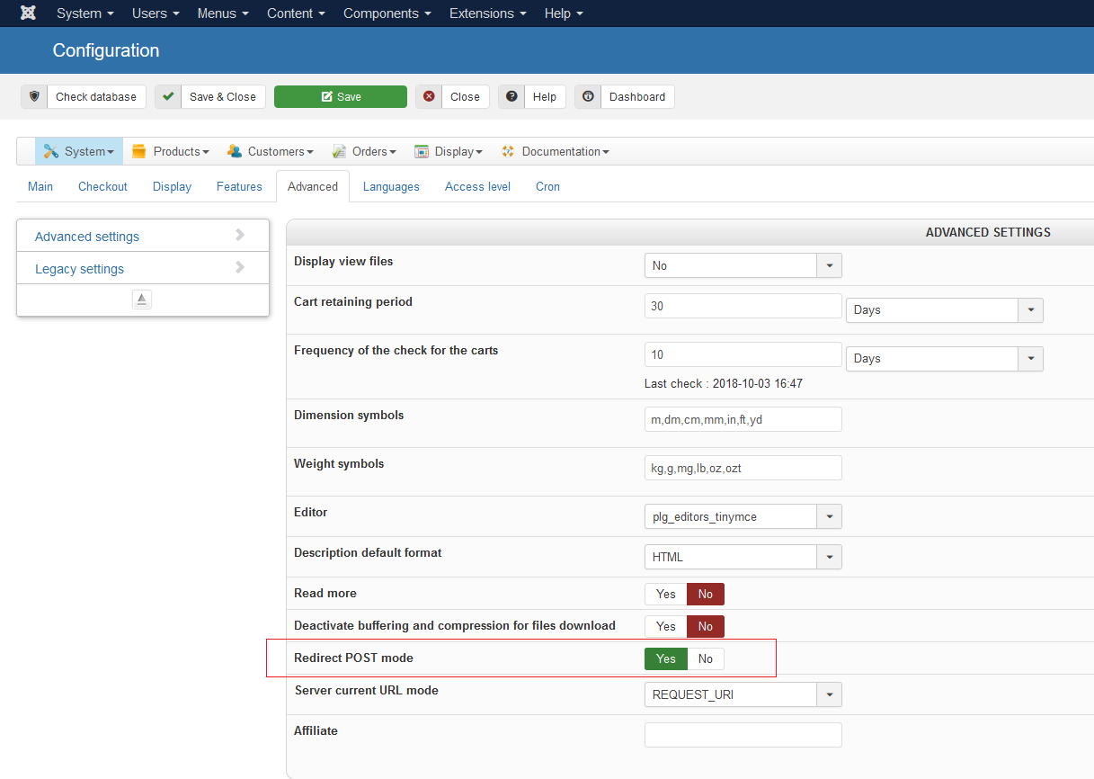

  • Posts: 14
7 years 8 months ago #298865
@nicolas where to find this option: redirect post mode?
I would like to realise the same thing as the TS, namely: showing filters in the url when using the filter module.
  • Posts: 1119
  • Thank you received: 114
7 years 8 months ago #298867
It's in system->configuration under advanced tab.
The following user(s) said Thank You: Philip, Jimmy Business
  • Posts: 85786
  • Thank you received: 14079
7 years 8 months ago #298870
It's in the HikaShop configuration, under the "advanced" tab.
The following user(s) said Thank You: Jimmy Business
  • Posts: 14
7 years 8 months ago #298907
It generates links like: category?limitstart=0&filter_NAMEFILTER=FILTER&filter_category_3=+
Is it possible to show a clean url such like: /category/filter
  • Posts: 85786
7 years 8 months ago #298929
If you keep that option turned off, it won't add these parameters.
These parameters in the URL are what allow the system to not need to use POST parameters (which are hidden).
So either you have that option turned off, or you have the parameters in the URL, you can't have both.
