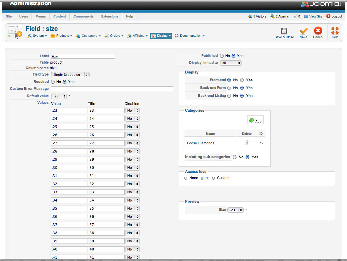

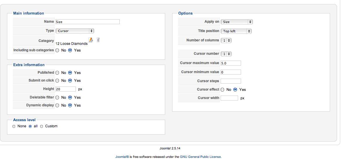

okay, i have a few screenshots for you
1. custom field
2. filter
3. module
4. what I get on website page where filter module is located.

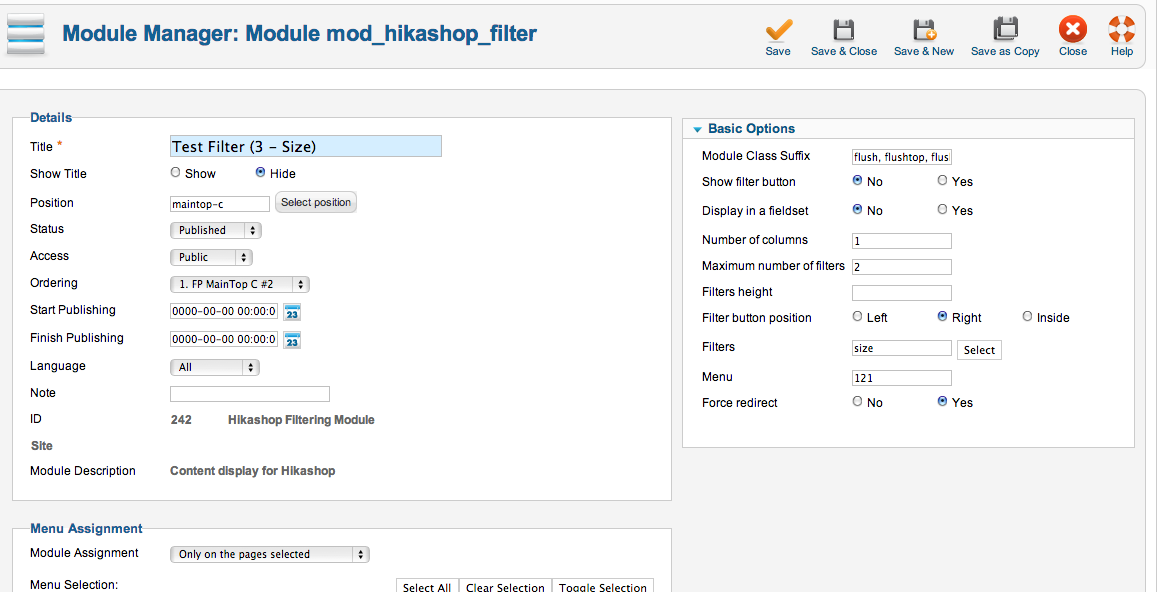

I am trying to create a cursor that goes from .23 (see custom fields) to the end, which is about 1.50. I call this 'Size'. So i want a cursor for Size.
  • Posts: 26382
12 years 10 months ago #125287
First I see commas in the suffix for the module. It is not a valid format, you just have to use a space.
But I don't think that is the real source of your problem.
The slider is using jQuery and it is highly possible that there is a jquery conflict in your website. We used the "jquery-ui" module and if jquery is redeclare, the ui module will be losted and it will create a javascript error.
With a link to your store we would be able to give your more details of the source of your problem. It is just a supposition with the elements we have.

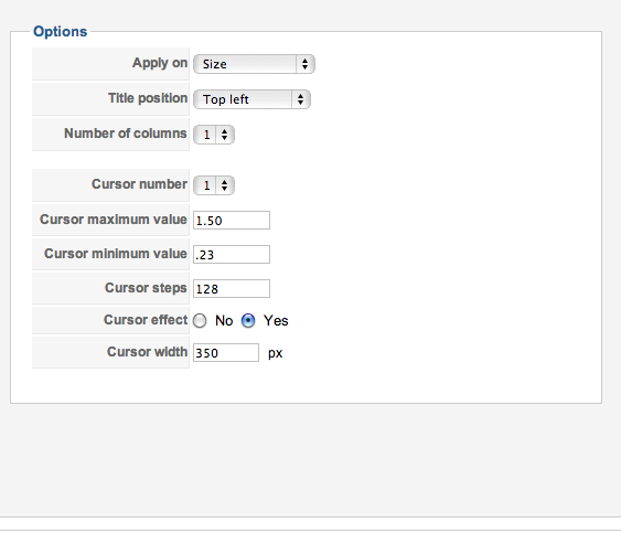

I set up the cursor, but can not get the individual steps to work. It moves only to end or start and not at each number.
In other words. I set it up from .23 to 1.50 and put cursor steps to 75. The cursor shows the end points .23. then, I can drag it to 1.50 and it goes to show all those in this range. This is the only functionality i can get.
Of course, I would like to be able to sort by each individual size (.23, .24, .25, etc etc).
  • Posts: 86058
  • Thank you received: 14184
12 years 10 months ago #125520
Please do a screenshot of the options screen of your filter so that we can see how you configured it.
  • Posts: 51
  • Thank you received: 4
12 years 10 months ago #125542
see attached photo
  • Posts: 86058
12 years 10 months ago #125605
The jQuery cursor system that we're using doesn't support float numbers. It can only handle integers. So you'll have to either change your "Size" element to use the decimals: from 23 to 150 or you would have to use another type of filter.
