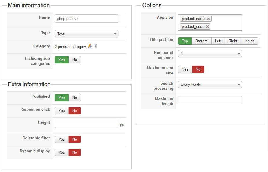

You have to configure your filter like that:
  • Posts: 13
12 years 9 months ago #131402
That is what i have on my filter and it only sends out all the categories (top and lower ) and no product.
Any other adjustment i should do?
Cheers
  • Posts: 86077
  • Thank you received: 14186
12 years 9 months ago #131475
The filter itself is ok. The issue is with the configuration of your hikashop filter module. In the options of the module, you should enter the id of a menu item of the type hikashop products listing which displays all the products if called directly (if you click on it on a menu module of the frontend). Then, when you use the filter in the module, the system will display that menu item and filter the products on it to only display the ones matching the text you entered in the filter.

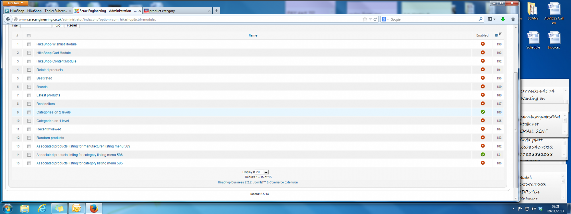

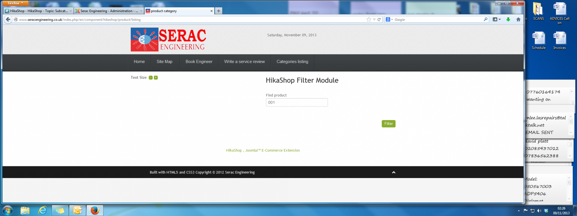

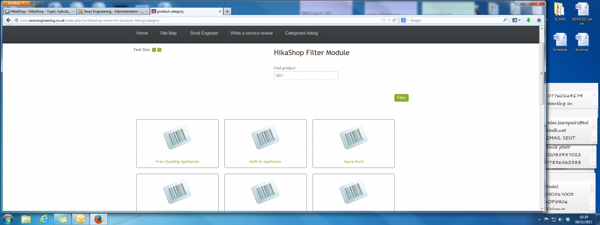

12 years 9 months ago #131574
Hi tried some other options and still nothing.
please check the pictures still only gives me the categories even putting the correct id number.
Any further suggestion.
  • Posts: 13
12 years 9 months ago #131575
Sorry here are the pics.

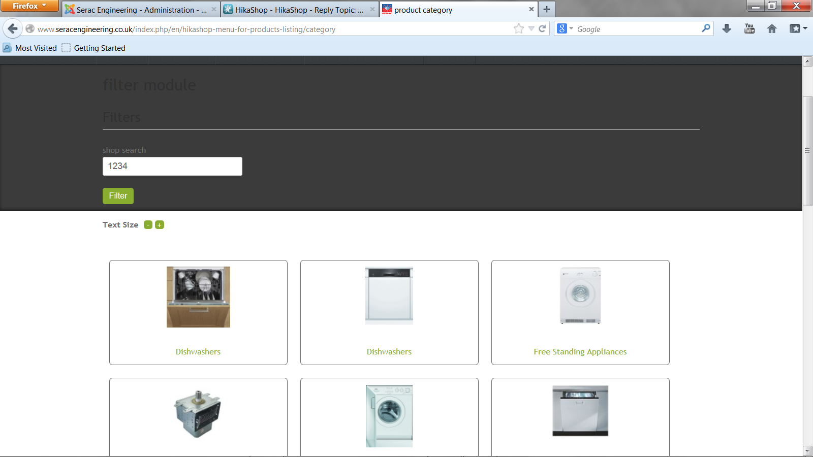

  • Posts: 86077
12 years 9 months ago #131583
As I said the issue was with the menu item that you set in the "menu" option of the filter module.
It was configured to display categories, not products.
I've changed it and it's working fine now.

  • Posts: 13
12 years 9 months ago #131610
After the test it's working properly , i did try 586 menu but it just wouldn't go.
Any way thank you very much :P and now i can get online. B)
