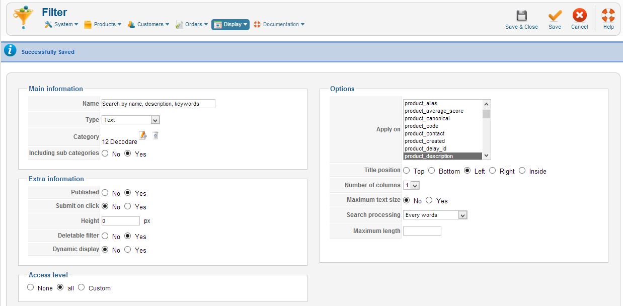

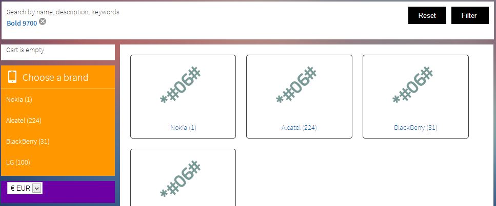

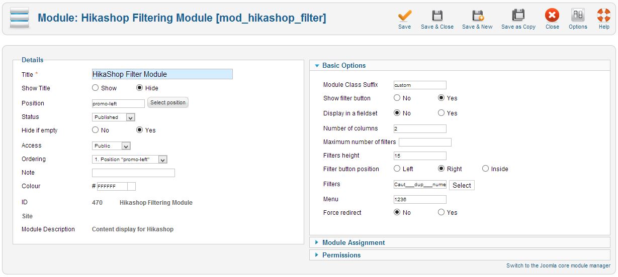

Hi, i set that filter to search for product name, description , and keywords.
The problem is , is not searching if i'm not on a product list,
If i'm on the page that show all the category and type some word in that filr, after refresh it show me the same page.

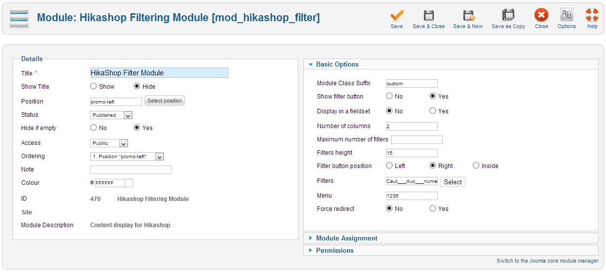

12 years 8 months ago #135043
You need to turn on the "force redirect" option of the module.
