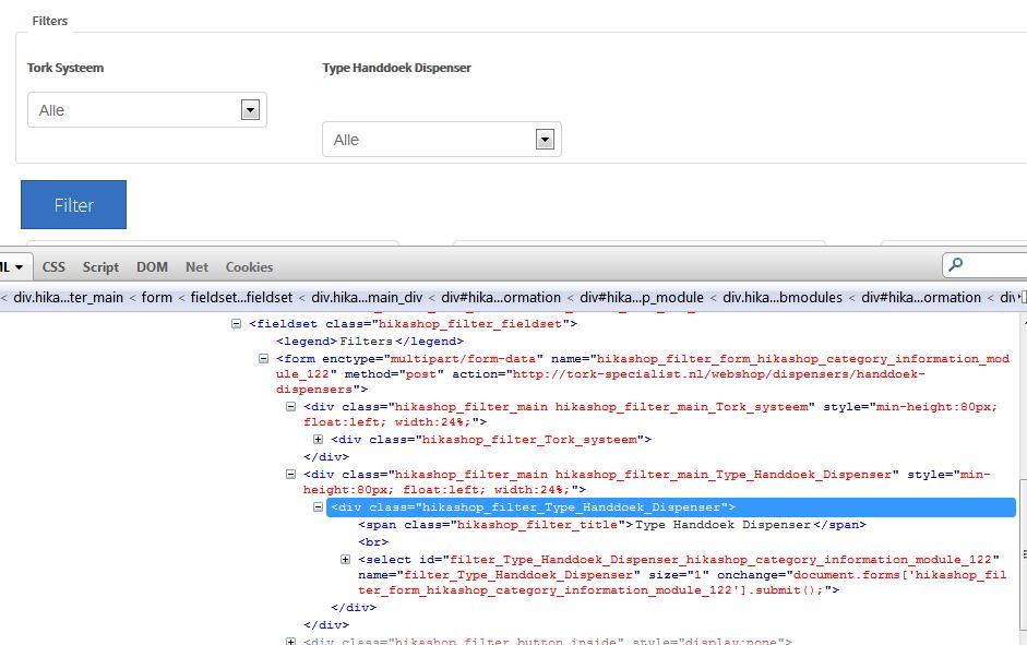

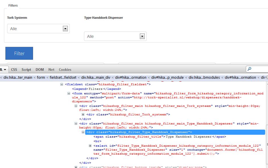

I have multiple dropdown filters above a categorie and it looks like the last filter is always moved down 1 line because of an extra <br> in the code.
Could not find if it was me who did this and where or if it's something in Hikashop.
Any tips on how to get the filters to show in 1 row again ?
Added a screenshot to make it clear what I'm looking at.
Thanks,
Nico

12 years 4 months ago #150760
You'll probably be able to fix it by using some CSS , but if you need more information, can you show me a link to the page where you are having that issue so that I can directly check it ?
Thanks.

12 years 4 months ago #150763
Hi Mohamed,
The site is not accessible from the internet, that's the issue.
But maybe the code screenshot from Firebug can give you enough info.
Let me know if it does not help.

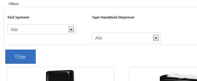

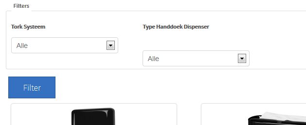

11 years 11 months ago #172530
Now the site is live I can show what's my problem.
In Firefox the filters are not aligned.
For example this page : www.lavette.nl/tork-webshop/dispensers/handdoek-dispensers
It looks like there is a linebreak that's causing this. But correct me if I'm wrong.
Thanks for all tips to make this align again.
Nico
11 years 11 months ago #172538
It's not aligned because the given space is to low for this kind of content.
You have to change the number of columns in your filter options.

11 years 11 months ago #172626
Hi Xavier,
Thanks for the response.
I'm afraid that I do not completely understand what you mean by "not enough space".
This because I only have 2 filters applied to this categorie and in my opinion there is enough room for these 2 filters.
For example on this page : https://www.lavette.nl/tork-webshop/handdoekjes there are also 2 filters applied, but they are nicely aligned alongside each other.
Changing the value of "number of columns" to 2 on both the filters in the options still puts one filter lower than the other.
One thing that is different from all the other categories is that this one is a sub-categorie (but maybe this is irrelevant).
11 years 11 months ago #172629
In Configuration > Features > Filters, thanks to set the option "Number of columns" to "2" and in Display > Filters edit your filters in order to set the numbe of columns to "1".
If that didn't solve the problem so you potentially have to do some CSS adjustments.
For example reduce the percentage of the columns widths.
Here is documentation for the CSS:
hikashop.com/support/support/documentati...ize-the-display.html
I don't think that being in a sub-category is the origin of the issue. Or if it is, it's because other css properties are used.
