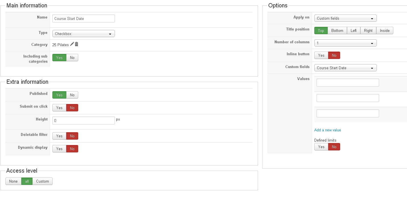

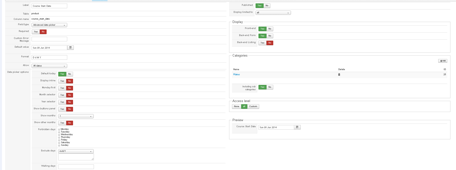

I am using a custom field of table "product" and field type "advance date picker". I would like to apply this custom field and create a filter.
I am able to create the filter choosing the correct custom field, but no data is displayed.
Could you advise what I am doing wrong?

The "advanced date picker custom field" is a plugin which has been finally integrated into HikaShop.
It store in the database the date is a specific format : "YYYMMDDHHMMSS".
The filters have types, like "checkbox" or "slider".
You have to choose a type and set the values you want.
For the moment there is no type "date picker" for the filters but it can be a good idea of a future development.
