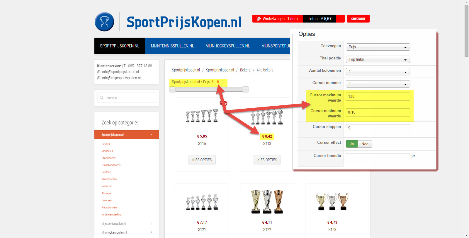

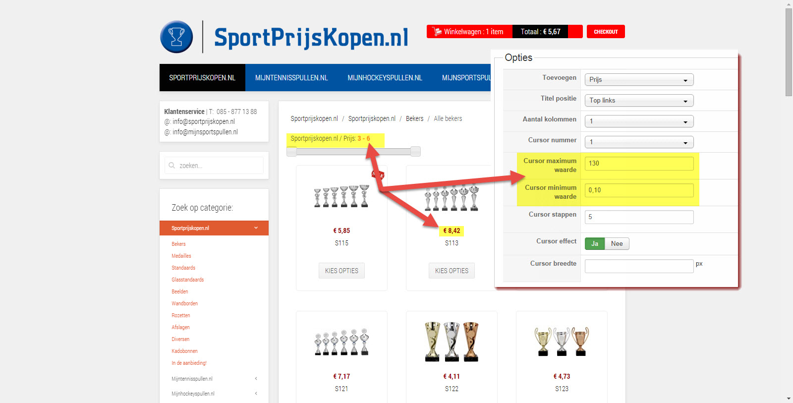

-- url of the page with the problem -- : www.sportprijskopen.nl
-- Joomla version -- : 3.3.4
-- PHP version -- : 5.3
-- Error-message(debug-mod must be tuned on) -- : Price filter not working well
The price filter isn't working well.
See attachment.
Jan

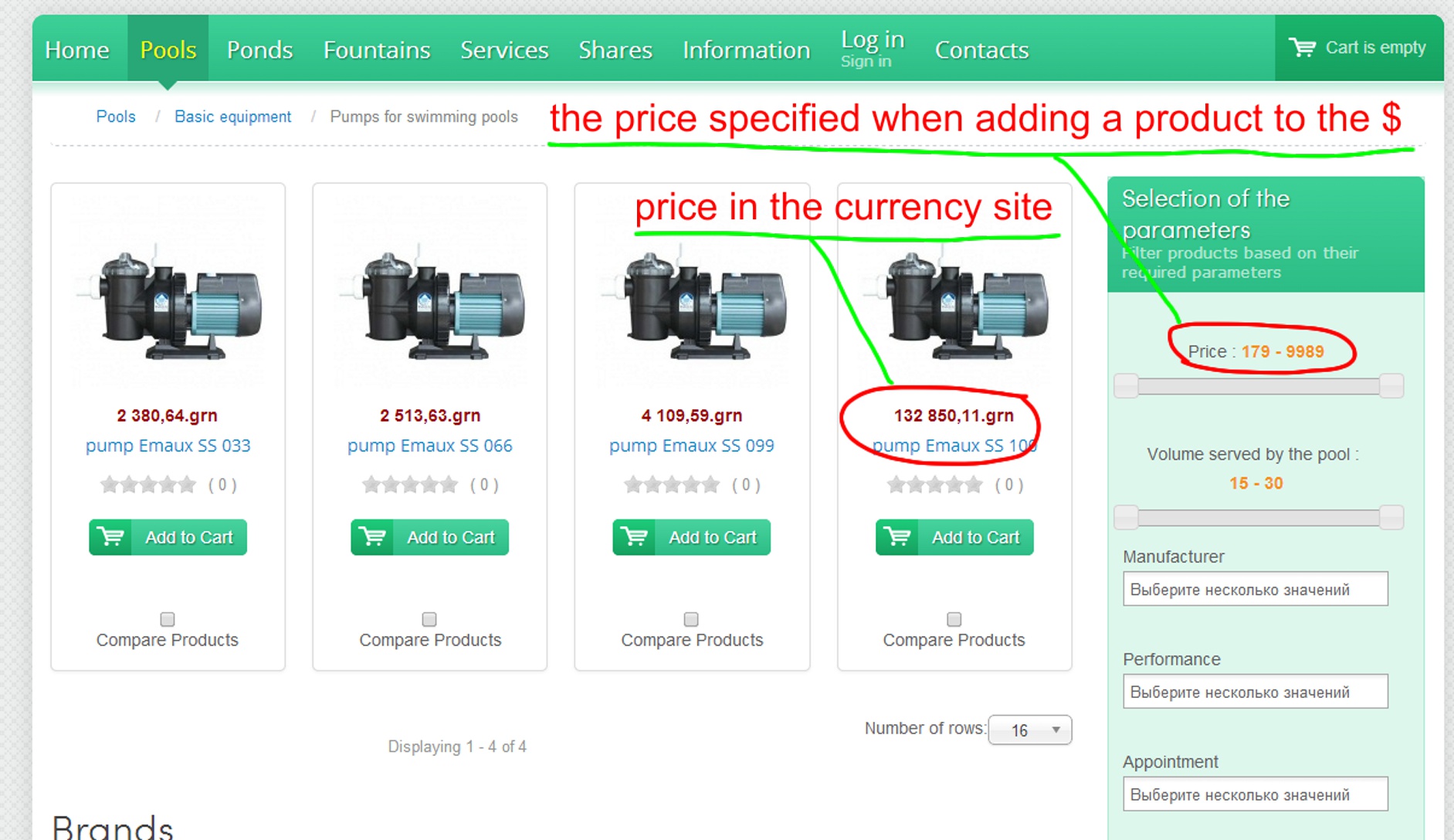

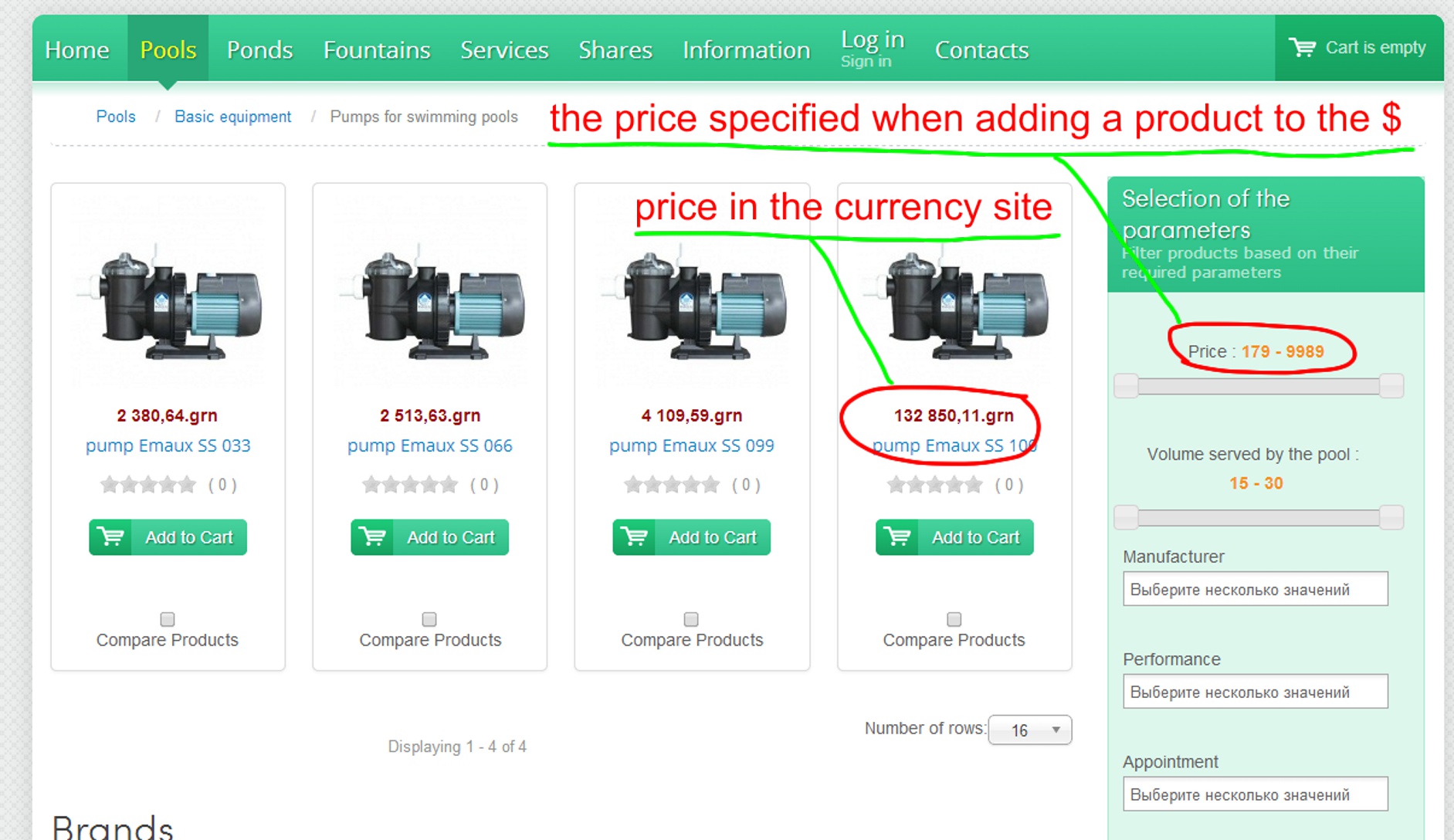

11 years 10 months ago #173852
Hi !
Have same problem!
On filter Hikashop->Display->Filters" need button filter on currency site or no.
Since i think this filter works only with price in the original currency, not the currency of the site
I am sorry for my bad english (

  • Posts: 33
11 years 10 months ago #174005
Mohamed Thelji wrote: Hello,
@Jan :The best solution will probably be to give me a temporary access to you back-end through a private message so that I can directly test it ?
@kassil : Can you give me more information through some screenshots so that I can understand your issue :) ?
Also, note that there is no option to dynamically change the filter Cursor maximum/minimum value regarding the currency used on your shop.
@Mohamed Thelji
On screen)
11 years 10 months ago #174045
@Jan : I just tested it on my and your website, and I'm only having that issue through your shop, so can you download the last Hikashop version through our website, install it and test it again ?
@kassil : As I told you, you won't be able to dynamycally change the filter Cursor maximum/minimum value regarding the currency used on your shop so you'll have to manually edit them through your filter configuration page.

11 years 10 months ago #174501
The problem was coming from the fact that :
- You have set the "Dynamic display" option to YES which was automatically setting the cursor minimum/maximum value regarding your product listing prices
- You have set the "Cursor minimum value" option to "0,10" instead of "0.10".
