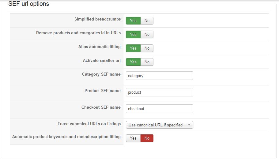

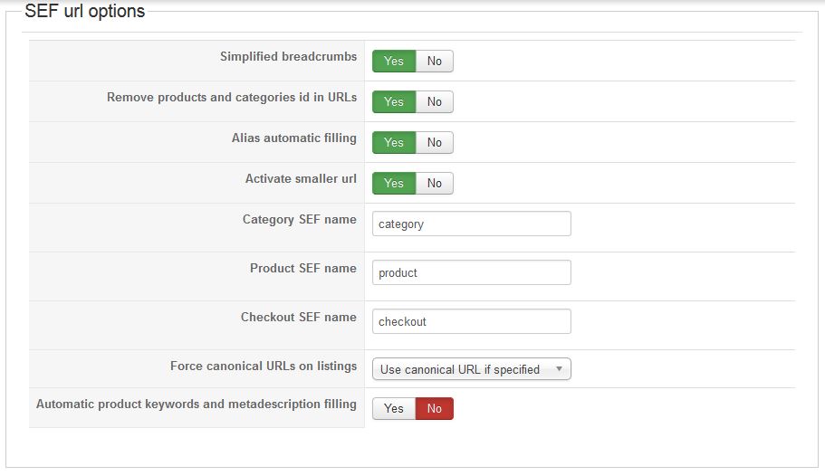

11 years 10 months ago #175510
Turn off the "Remove products and categories ids from URLs" option of the HikaShop configuration and you won't have the problem.
