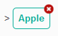

Hey guys,
first of all: I love HikaShop, it's one of the greatest extensions for joomla! I've ever seen. BUT :lol:
I'd like to remove the little ">" which is displayed in front of the selected filter label (see attached image).
I tried to find it in various .php's, css's ... but I was not able to locate it.
Thank you & best regards!

comceptplus wrote: I'd like to remove the little ">" which is displayed in front of the selected filter label (see attached image).
I removed them as well.
In 2.3.4 you'll find a bunch of them in the file administrator/components/com_hikashop/classes/filter.php
See lines 872, 884, 898, 908, 915, and 918, each time right near the beginning.
But careful, it's a core file, so after the next update they'll be back again unless you prepare for it.

Wow, thank you for your extensive answer - everything worked out well! Thank you very much!
