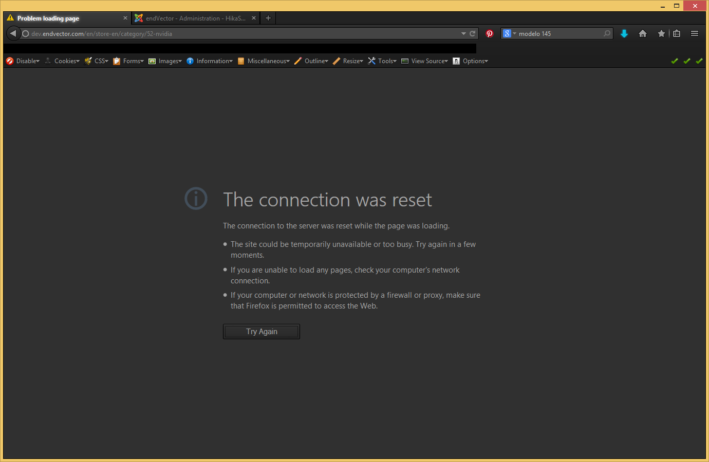

Hi Colleagues,
I just upgraded to business edition and was testing the Custom Fields and Filters but have run into a problem.
I have created three Filters:
1) Manufacturer / Single Dropdown / Apply On: Brands
2) Chipset / Single Dropdown / Apply On : Custom fields (already created and populated based on product)
When I browse the categories in my shop the filters show correctly with all the defined information. I am able to apply to Manufacturer filter successfully but when I select the Chipset dropdown and apply I get a timeout on my browser.
Any ideas why this can be happening?

  • Posts: 14
11 years 10 months ago #177693
Hi Jerome,
The error you are seeing is the Forefront error given by user accessing via WAN when the connection is reset.
Internally I have attached what we can see within our LAN. Same error, just a different screen.
Would you be willing to schedule a remote session to look into the issue?
Thank you!

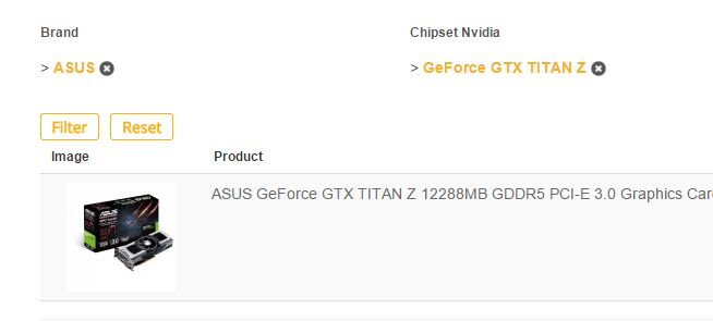

Reinstalled Hikashop 2.3.4 but now when the filter is applied no items show up even though the Dynamic Display is only showing the values provided by the products.

  • Posts: 14
11 years 10 months ago #179517
Hi Jerome,
If you only filter by "Chipset Nvidia" or "Memory" no results are shown, even though Dynamic Display is only showing the values provided by the products.
Also, if you remove the filter using the "X" no results are then shown back. You have to use the Reset button.
