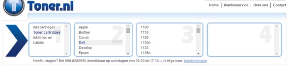

I would like to build a menu and or search function like this example.
. (http://www.toner.nl/)
the 4 boxes:
1.article category
2 >brand
3 >>type printer
4 >>>result: product article number
Has anyone a good tip which module or even external extension I could use for this?
I know quite some javascripts but I am not sure if the compatible with hika ?
Second (may be a stupid beginner question:
If I want to use the hika shop products or cateagory search plugin, how can I display the search box?
Or do I set the standard joomla search or advanced search module?
Tks

The hikashop search plugins are compatible with the Joomla standard search system, so if you use them, you would want the joomla search module to be enabled.
Regarding your filters, you can create custom product fields via the Display>custom fields menu and then create filters on these custom fields via the menu Display>Filters in order to have such advanced search.
You can have them depend on one another by activating the "dynamic display" option of your filters.
More information is available here:
www.hikashop.com/support/support/documen...-filter-listing.html
