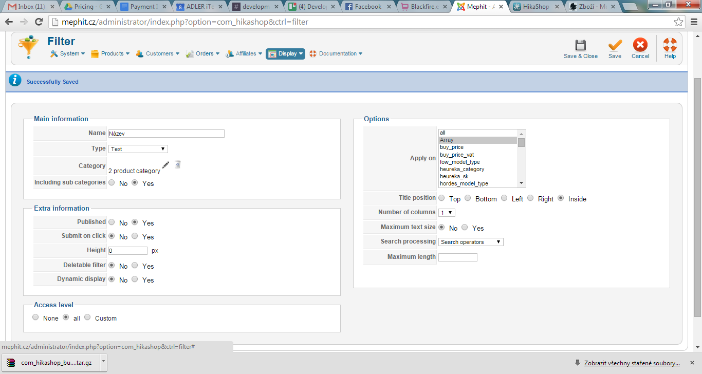

1) I've configured my text search filter as per the attachment (note I actually wanted the filter to be set against product_name but upon save this gets overrided by array).
2) When I go any page where the filter is enabled say mephit.cz/cz/zbozi/category/165-rodinne and filter on any product name (such as Osadníci z Katanu) the product is not filtered.

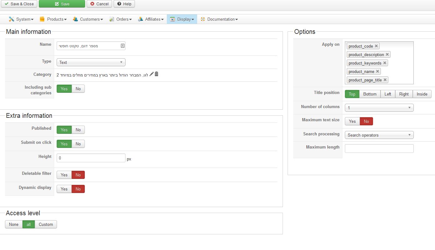

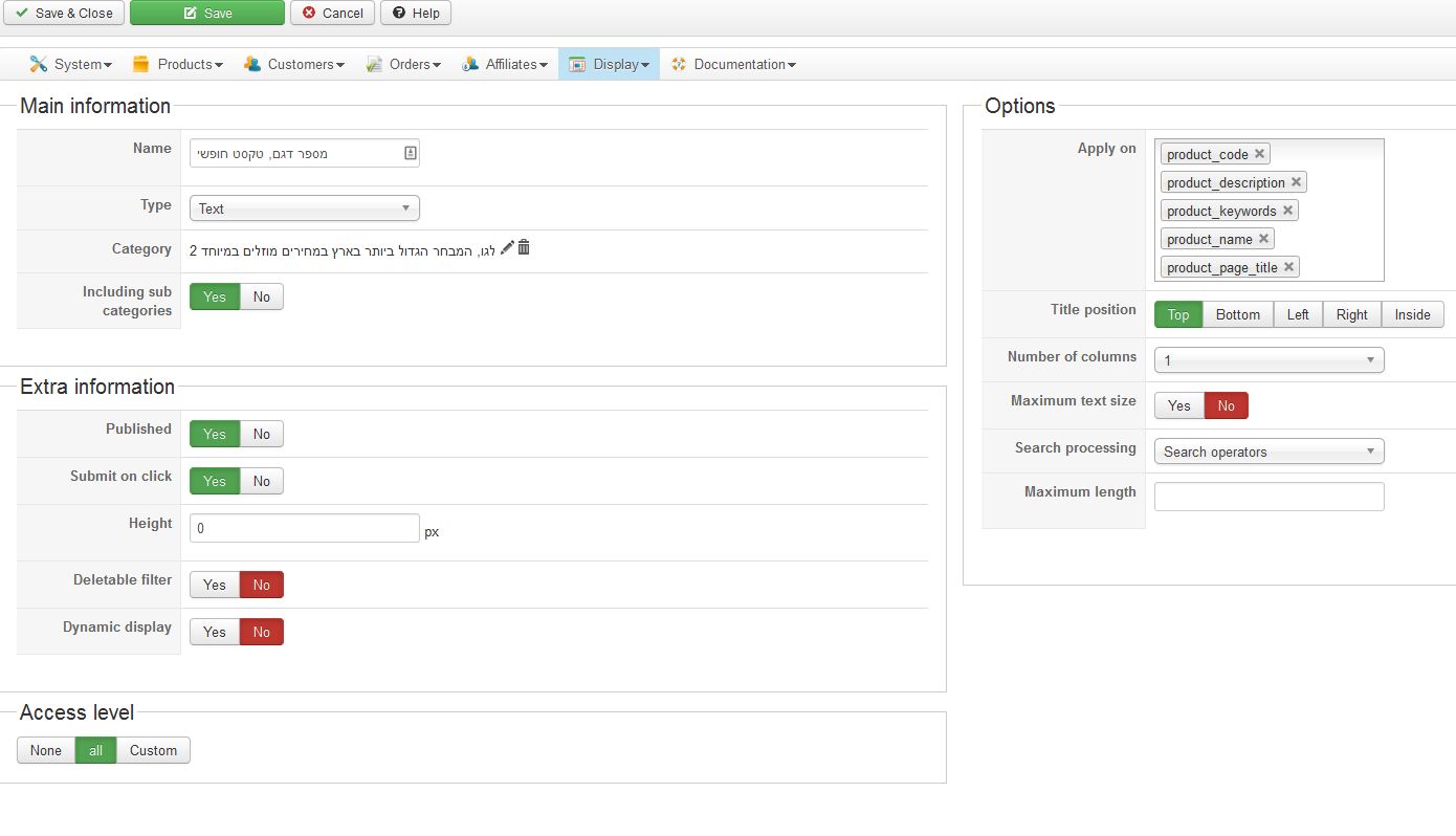

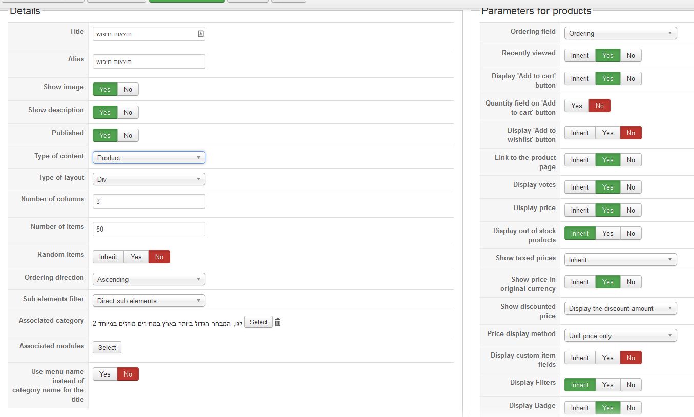

  • Posts: 108
11 years 6 months ago #193766
The text filter on my end is returning no results.
pls see the config in the attached files.
Thank you

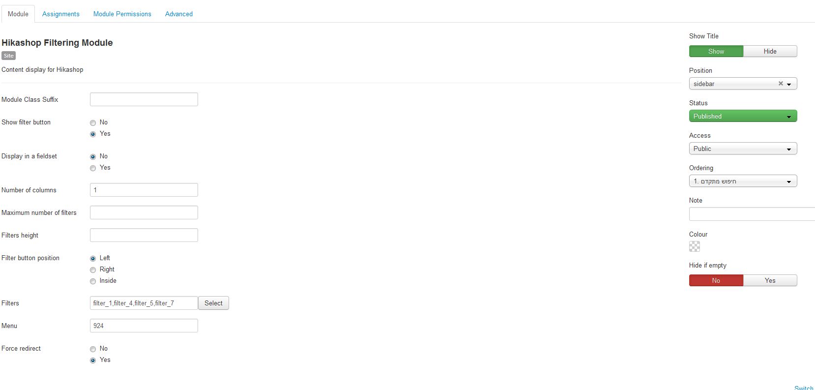

  • Posts: 108
11 years 6 months ago #193936
I tried each one of the options and neither made any change, I just got no results.
The main purpose of this text is to look for a specific product code.
any suggestions?
thank you.

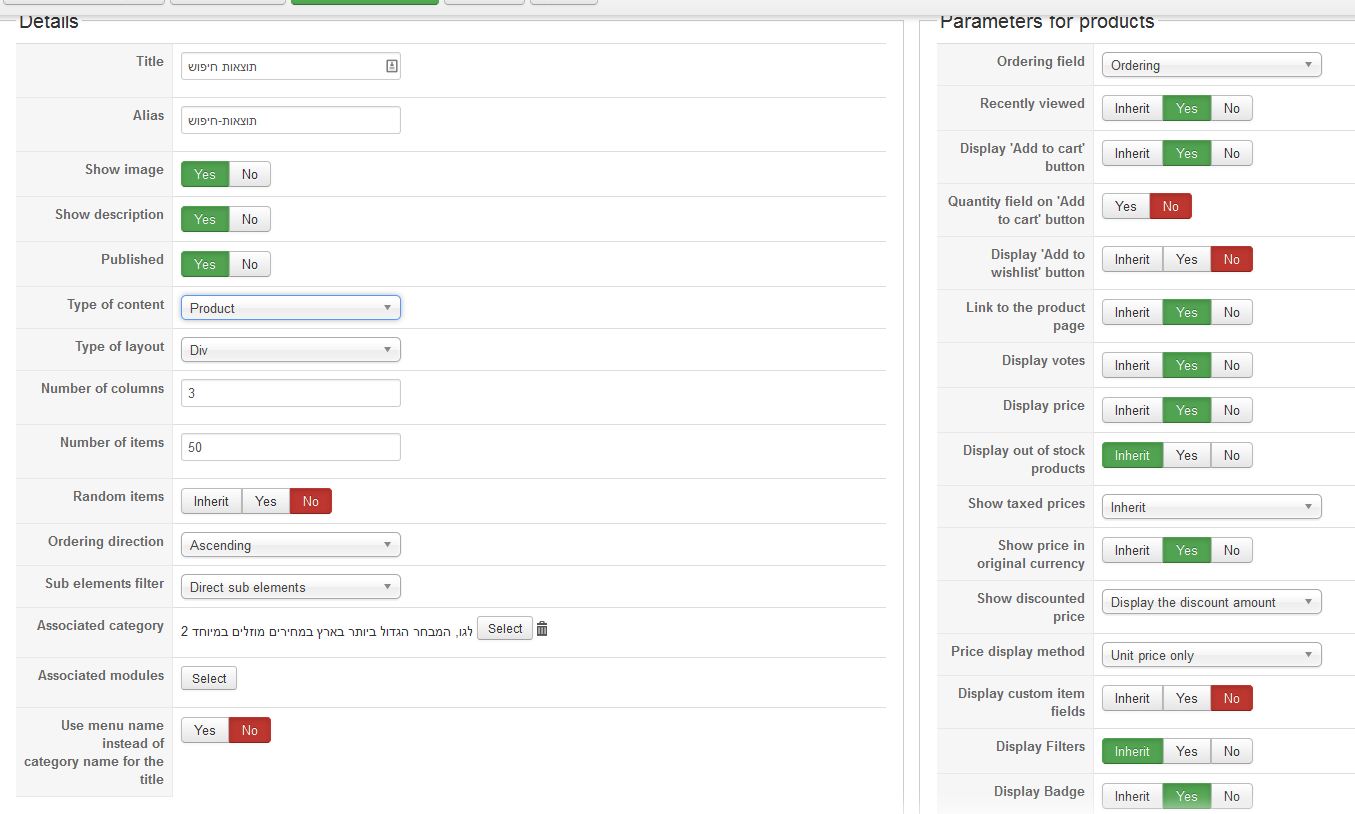

  • Posts: 86220
  • Thank you received: 14222
11 years 6 months ago #193957
The issue is with the menu settings, not the filter. The "sub element filter" option should be set to "all sub elements" and the "recently viewed" option should be deactivated.
The following user(s) said Thank You: shoppist
  • Posts: 108
11 years 6 months ago #194050
working great, thank you!
