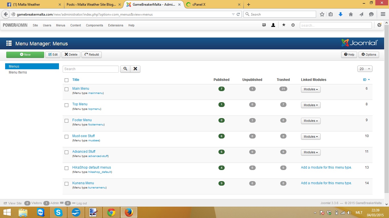

11 years 6 months ago #193178
thanks but not quite understanding. Is it any of these (see attached)?
  • Posts: 26386
  • Thank you received: 4078
11 years 6 months ago #193182
Please forget about the "Itemid", it is useful only when the search is working and if you want to provide some specific links to the products/categories.
You can leave the field blank without any trouble...
