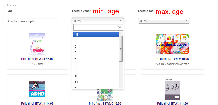

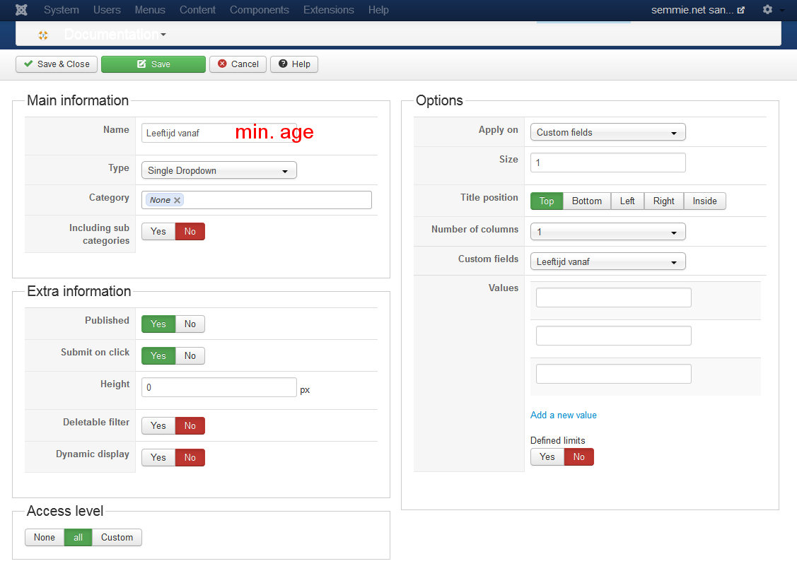

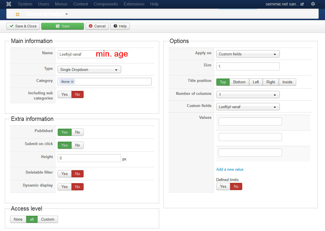

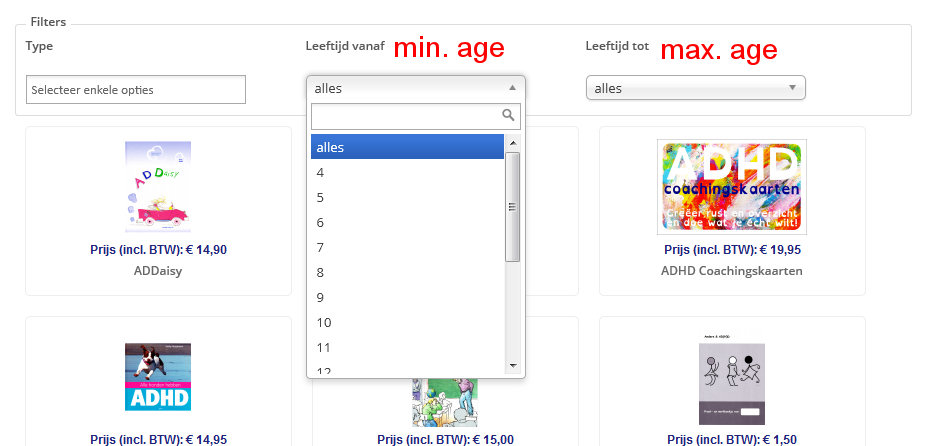

11 years 5 months ago #193830
Hello Xavier,
In the original VM webshop they used a dropdown for minimum age and maximum age, so I did this als o in Hikashop.
See pictures.

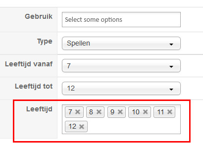

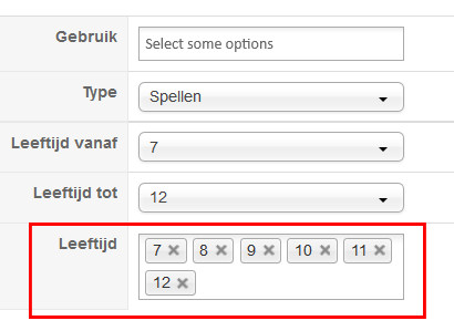

11 years 5 months ago #194483
Hello Xavier, I do have a solution, but it is not working OK.
This is what I do:
I made a new custom field 'leeftijd' (age) and put all values in it (see screenshot)
I also made a new filter of the type: cursor (4..18)
It looks if it works fine, but not always.
I have product A (7-12) and product B (7-15)
If I filter between 7 to 15 I will see both products, that's OK.
But if I filter between 8 and 15 I do not see any products.
Do I filter between 6 and 15 I will see both products, that's OK.
It seems Hikashop filter needs the lowest value you have entered in custom-field.
So I think this is a bug.
