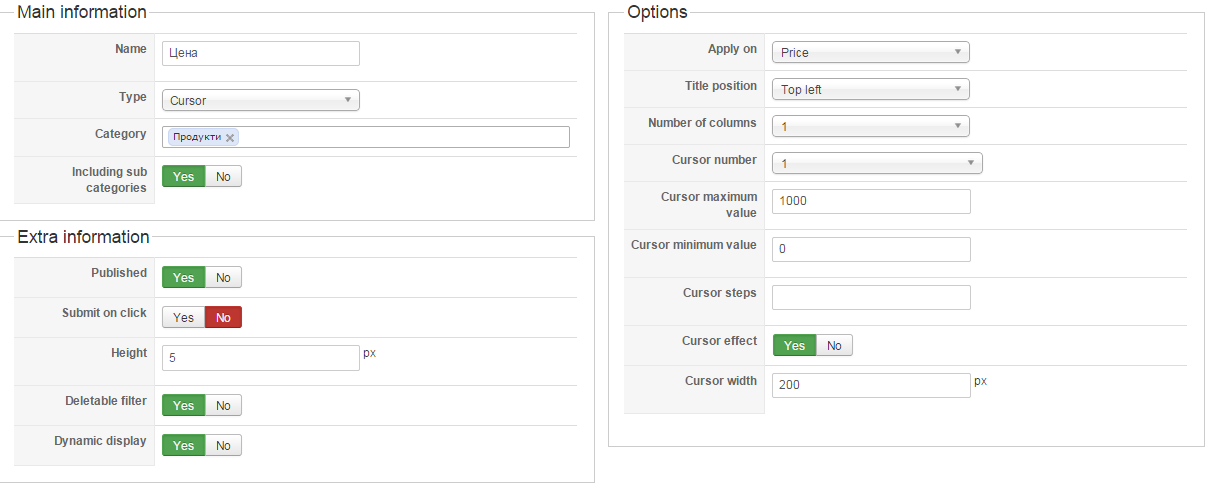

Hi.
on price filter second submit values are not shown although they are still active:
1. Before submit
2. After first submit
3. After second submit
4. Filter settings
Regards!

11 years 4 months ago #196095
no it is not the same issue.
The filter itself is active and works as expected but the values of the price filter disapear after the second submission. In other words.
1. On selecting price filter and submitting the whole filter - OK (results are as expected and selected price filter values are shown)
2. On already selected price filter submitting the whole filter - NOK (results are as expected but filter values are not shown)
Thank you!
