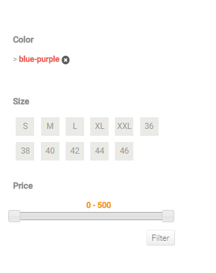

-- Joomla version -- : 3.4.1
-- PHP version -- : 5.5.12
I created 3 types of filter on my products. I want to filter them by color, size and price. user must click on the filter button to activate the filter.
when I choose a color for example, the list of colors disappear and we can see just the selected color(s).
how can I display the list of colors and the selected colors at the same time?
I wish also to put a border to a color (like picture filter3) if we click on it, and remove the border if we click twice on the same color.
Thank you

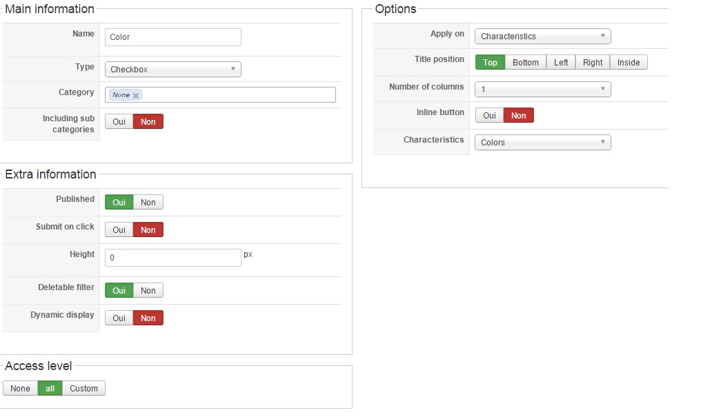

  • Posts: 47
11 years 4 months ago #196572
I tried to switch the two options with different combination but there is no change.
I attach you the details of my filter.
If I put Deletable filter to no, the delete button disappear.

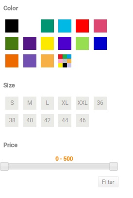

  • Posts: 28
10 years 4 months ago #235302
I have this problem now and I can't work out why. I have two different sites with similar settings but it doesn't work on one of them. See screenshot.
I've toggled all the settings and nothing works correctly. Turning off dyanmic display will show keep all of them visible but it shows filters which are not in the current category and subcategories.

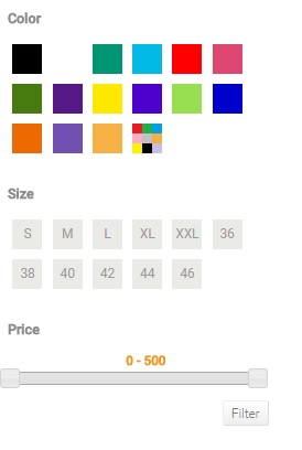

  • Posts: 28
10 years 4 months ago #235593
10 years 4 months ago #235629
In your case you have to enable the "dynamic display" option in order to have only the filters related on the listed products.
And you should disable the "Submit on click" option, that way the customer will be able to check more than one checkbox at the same time.
But we can't display only the filters related on the listed products and keep them all after filtering on one of them.
