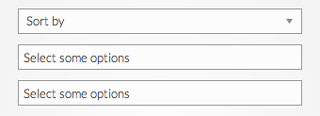

I have several dropdown filters, all with title position = inside, to save space.
One is single dropdown, and the title (= filter name) indeed shows inside.

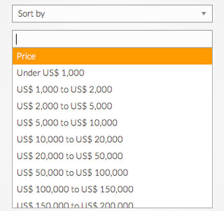

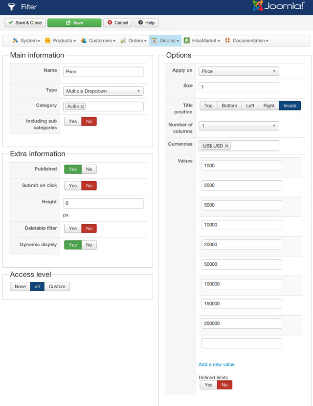

Several others are multiple drop downs (typical setup as per attached screenshot), but instead of the titles there's "Select some options" showing for all of them, making them all look the same. Only if you click on one, the title shows in the first row of options.
See here when closed:
See here when opened:
How can the filter title/name be displayed instead of "Select some options"?

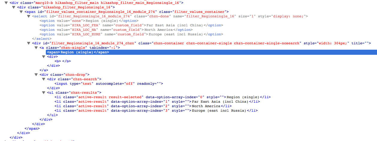

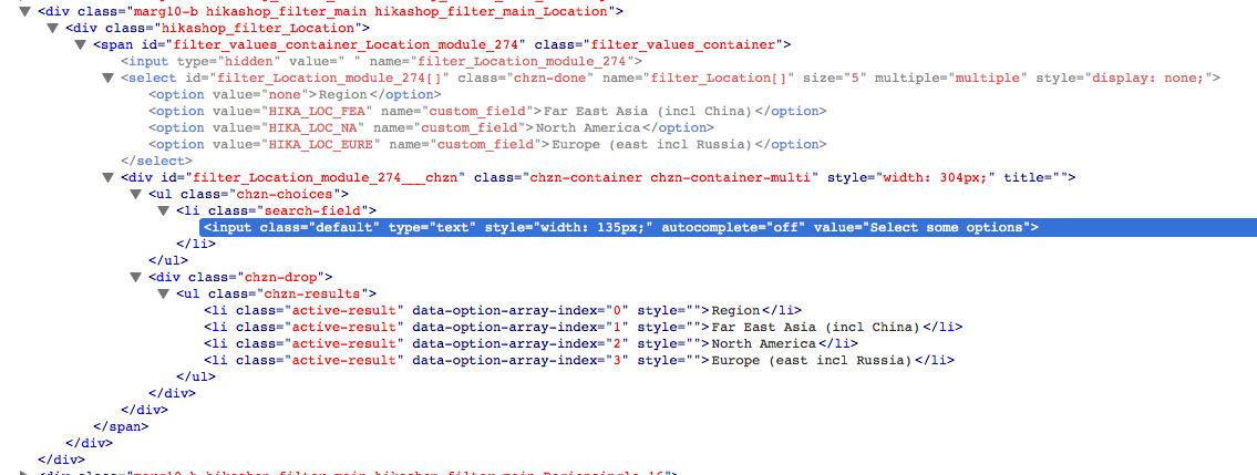

With the Chosen library enabled in HikaShop, I created two filters from the same custom field, one single, the other multiple dropdown. Please look at the different HTML and note the difference. I highlighted what is visible with dropdowns closed, and you see that for the single dropdown the placeholder was replaced by "Region (single)", and for the multiple dropdown it's not "Region" as should be, but it's still the default ("Select some options" as per Chosen JS):
Single dropdown:
Multiple dropdown:
