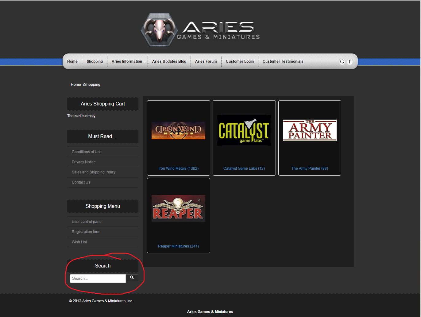

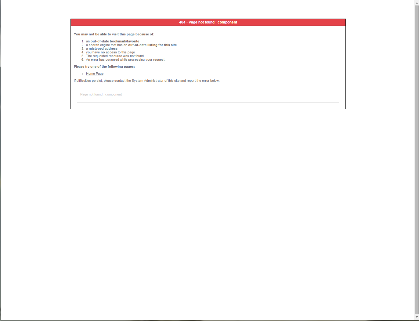

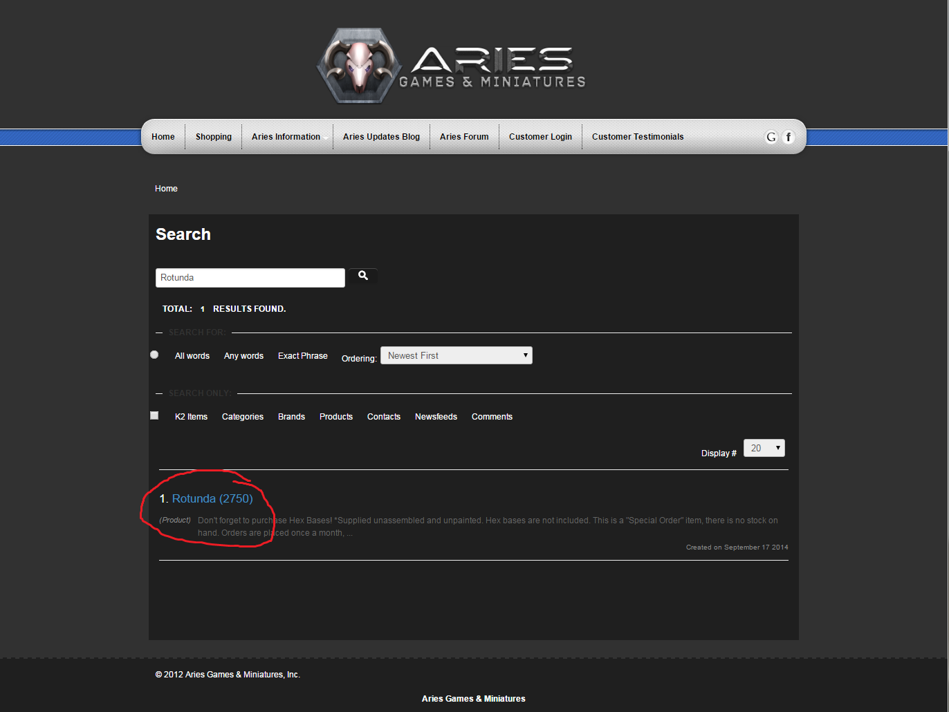

When I updated to 2.5.0, it seems my search function broke...and I cannot seem to figure out how to fix it. Currently, when you enter a product to search, it takes you to the search results, but when you click on one, that directs you to a 404 error page. Any help would be appreciated, images attached for reference...
If you need to try it yourself, please go to my site & click the shopping link on the main menu...then follow the below instructions...
Search 1 - Bottom left corner is the search function under the shopping link.
Search 2 - Result from doing a search (this case I used the product Rotunda)
Search 3 - The 404 error I receive
Other items you can search for as well are listed below just for example...but ALL items on my site when searching give a 404 error...

I unzipped it first, then uploaded via FTP, and installed from directory. Per Joomla, it installed correctly, so I waited a minute, went in to my cpanel, and flushed the cache just to be safe...and yet it still during searching, gives me the 404 error code when clicking on the results of a search...BUT, it is allowing me to click on a link & give me a few returned searched items as full page. So it's partially working.
If you go to my site, click shopping, then in the search box type Osteon...it will give you 4 results. The results for the Osteon Prime and Osteon Jaguar give me a 404...whereas the Osteon D and the Battletech Blog links go all the way through to the proper page.
If you search for Rotunda, it will give you 1 result, which leads to a 404 page as well.
