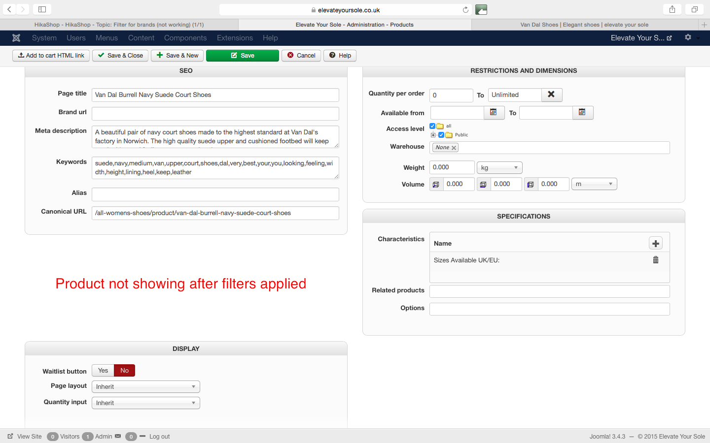

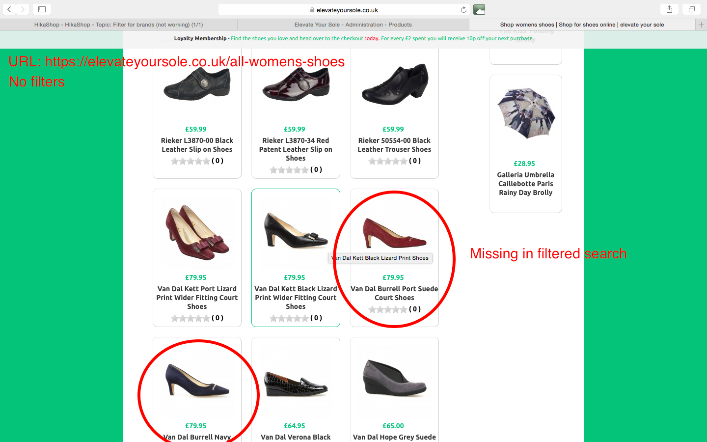

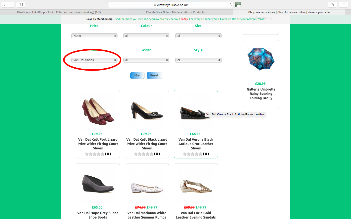

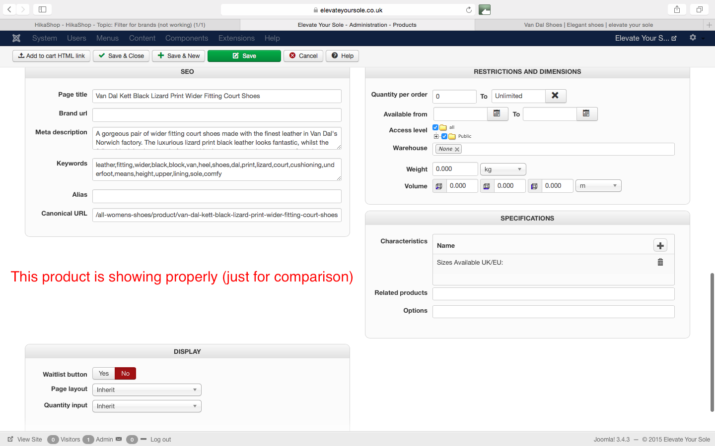

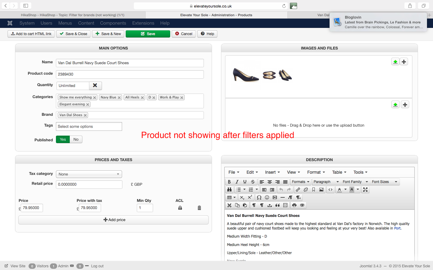

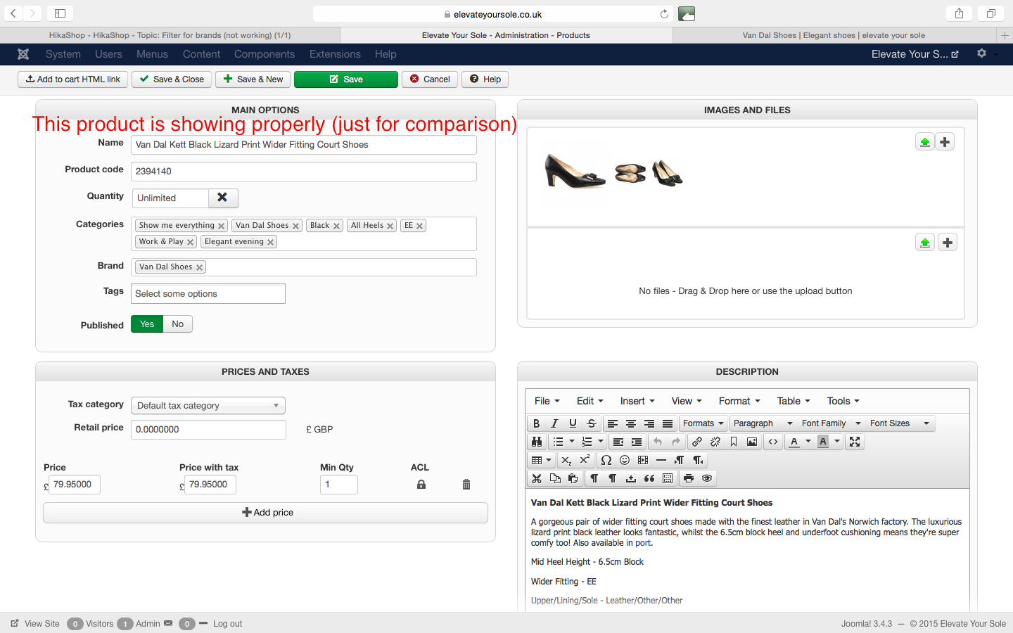

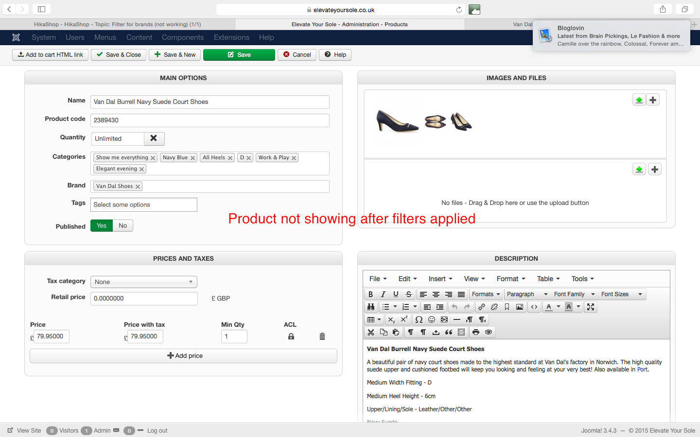

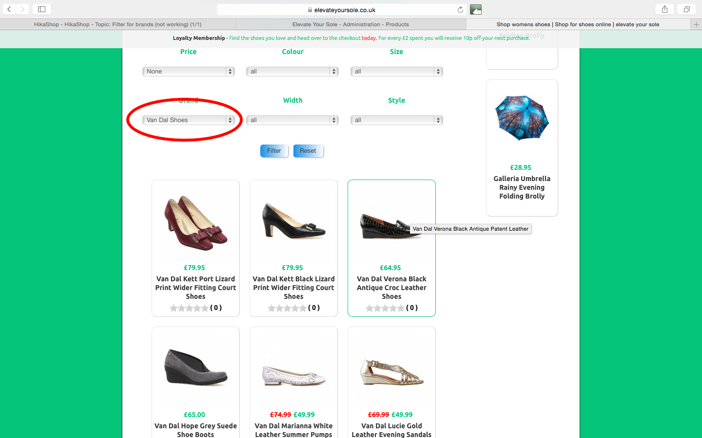

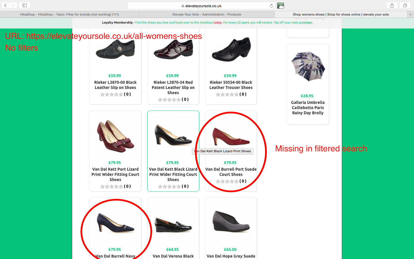

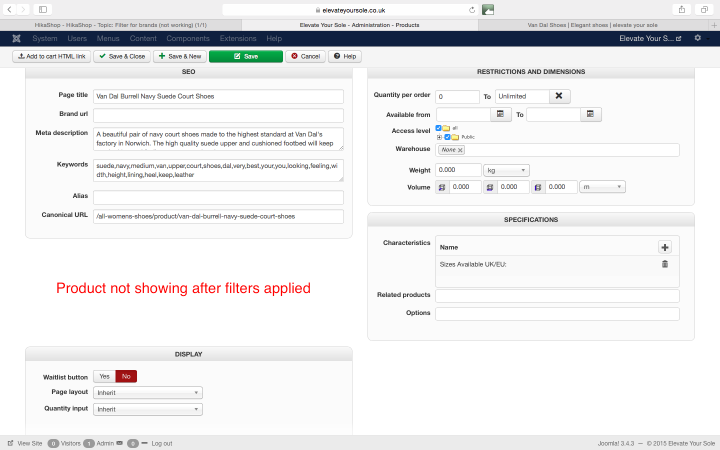

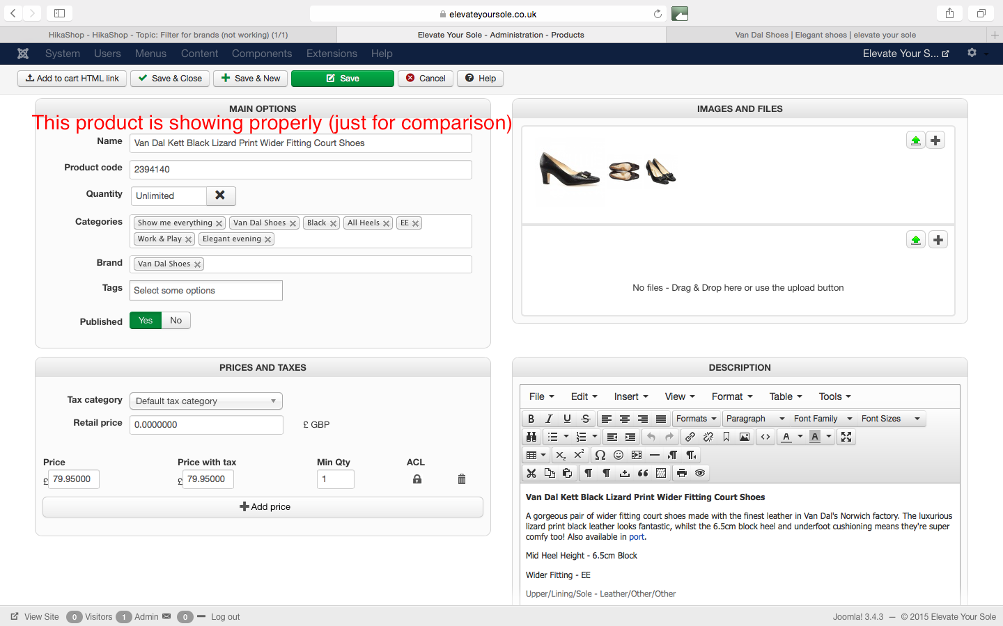

I'll try my best to explain using the screenshots. It's really strange, because some of the new products are showing, whilst others are not. The order by which the products are displayed is 'newest created'. I have also attached examples of a product that works with the filter and one that doesn't.

So I've checked your backend as I still had an access you had provided before and I found the issue:
It's because your filter is not a brand filter. It's a category filter. So it look for that brand in the categories of your products.
You see the other products in the results because you added that brand as a category in the other products.
So the filter is working just fine the way you configured it.
