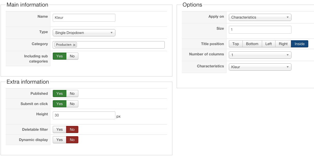

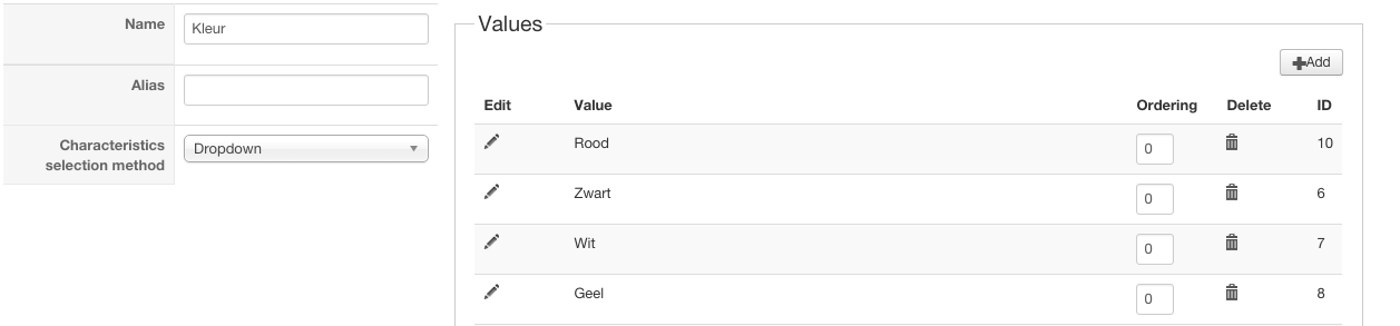

Can you try to turn on the "redirect POST mode" setting of the HikaShop configuration page and see if that helps ?
Could you also provide a screenshot of your characteristics filter settings page and one of your characteristic settings page ?

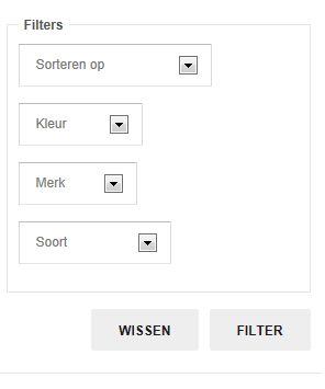

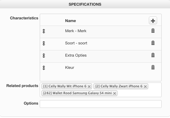

10 years 11 months ago #214108
the screenshots:
Filter
Characteristics
Products
Products variants

  • Posts: 27
10 years 11 months ago #214200
Cause of adding a reset button, yes.
But no products are shown when you add a color filter.
In the screenshot you can see the characteristics is added to the products
update: If i add a filter by brand first, the color filter works like a charm, but otherwise it shows no products. I am curious.
