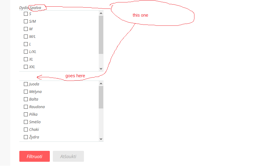

I am looking how to modify filter via hikashop display>view
I would like to change filter title position to be show under borders. It is easy with firebug to cut and paste....
Please check my pictures attached. On first picture this is what I have right now and on second picture this is what I would like to have. If someone could tell me what code I should change in display>view>filters I would be very thankful.
I could make 3 filter modules and hide filter title with css but in that situation every filter selected would reset other selected filters....

What you'll want to do is first add CSS in order to hide that title inside the filter area.
Then, you want to edit the file "filter" of the view "product" via the menu Display>Views and display the filter title, before the area of the filter.
So, before the line:
<div class="hikashop_filter_main hikashop_filter_main_<?php echo $filters[$count]->filter_namekey; ?>" style="<?php echo $height; ?> float:left; width:<?php echo $widthPercent*$filters[$count]->filter_options['column_width']?>%;" >
you'll want to add such code:
<?php echo $filters[$count]->filter_name; ?>

Thanks for replay. I did what you said but as I have 2 filters so both titles are displayed... Please check picture. Is there any other code I could use to display it correctly?

nvm I have put this code and it works:
<div class="hikashop_filter_title2"><?php echo $filters[$count]->filter_name?></div>
it is working and I hope it is correct.
Thank you Nicolas for your support, appreciated :)
