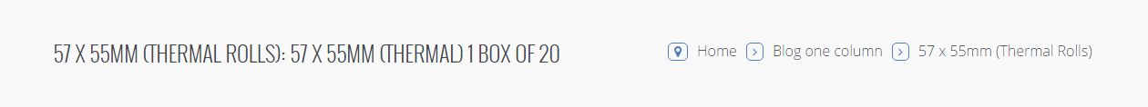

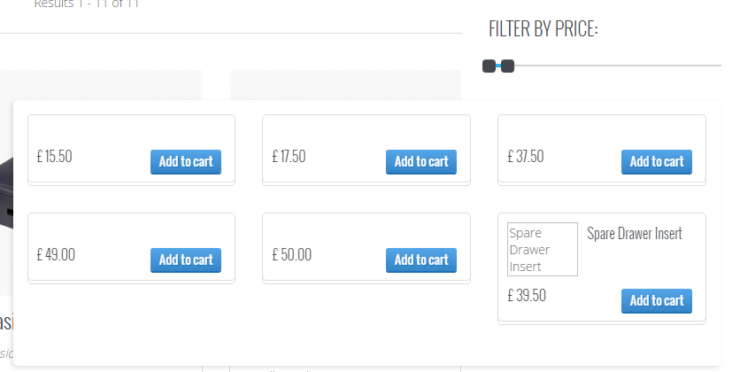

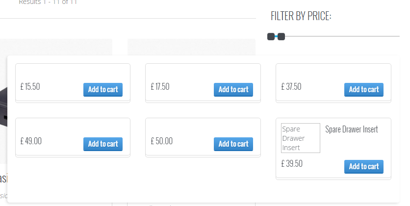

I have put my option products in root - product category - options
when using price filter these items are displayed and they shouldn't be.

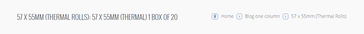

They also go to a random menu that has been unpublished
windows-epos.co.uk/index.php/component/h...uct/3679-?Itemid=445
Last edit: 10 years 9 months ago by microtill. Reason: Incorrect image uploaded
  • Posts: 86077
  • Thank you received: 14186
10 years 9 months ago #220033
What you want is to first make sure that the category is disabled.
Also, if that's not enough, you want to configure the products listing menu item you're using in the hikashop filter module's menu item setting so that its main category is the main category above your normal products, leaving the options category outside of it.
That way, the option products will definitely not be taken into account by the filtering system.
