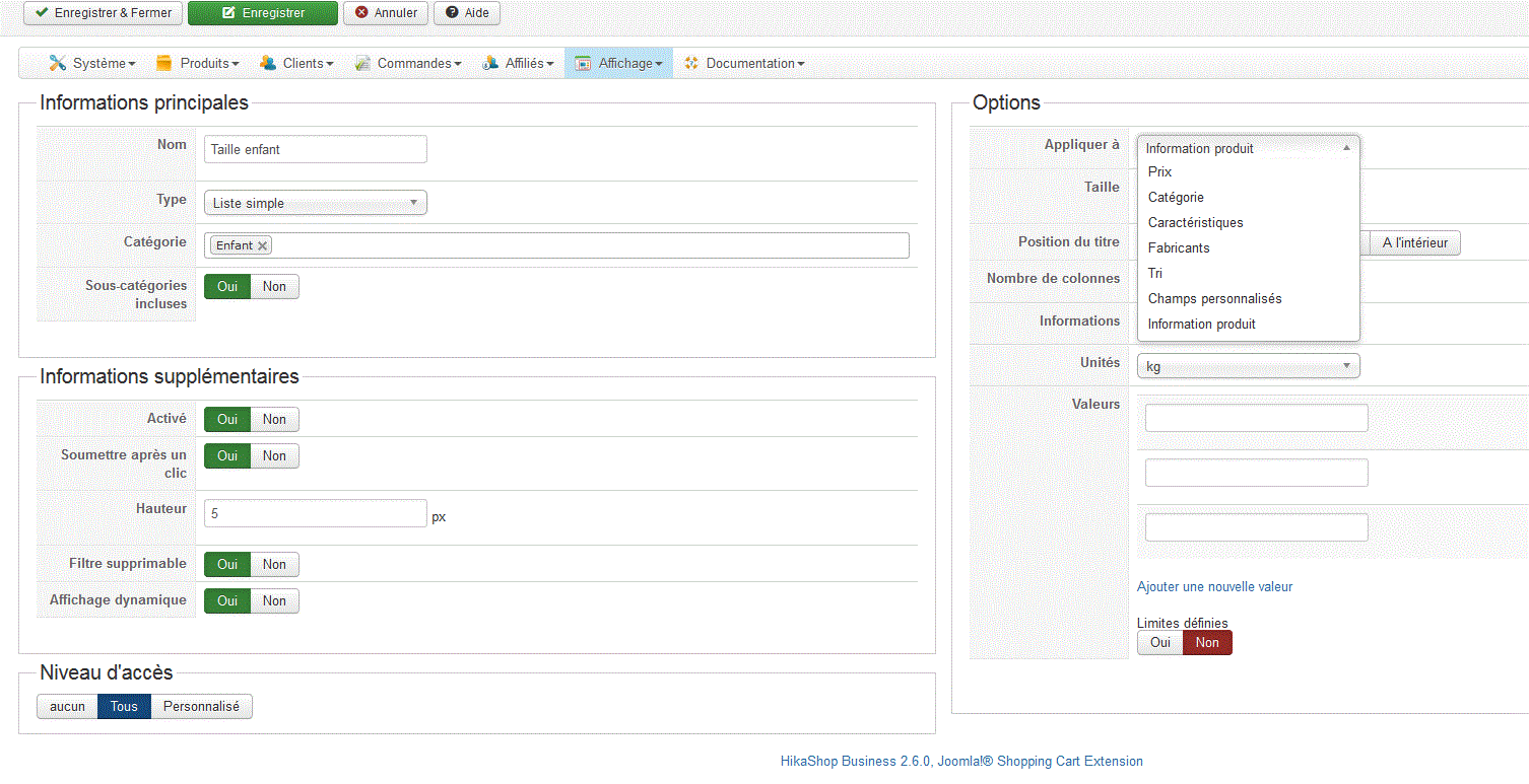

So you want to create a custom product field via the menu Display>Custom fields so that you can select the size of the tire in each product. Then, create a filter via the menu Display>Filters and select that custom field as data applied on the filter and that will do it.

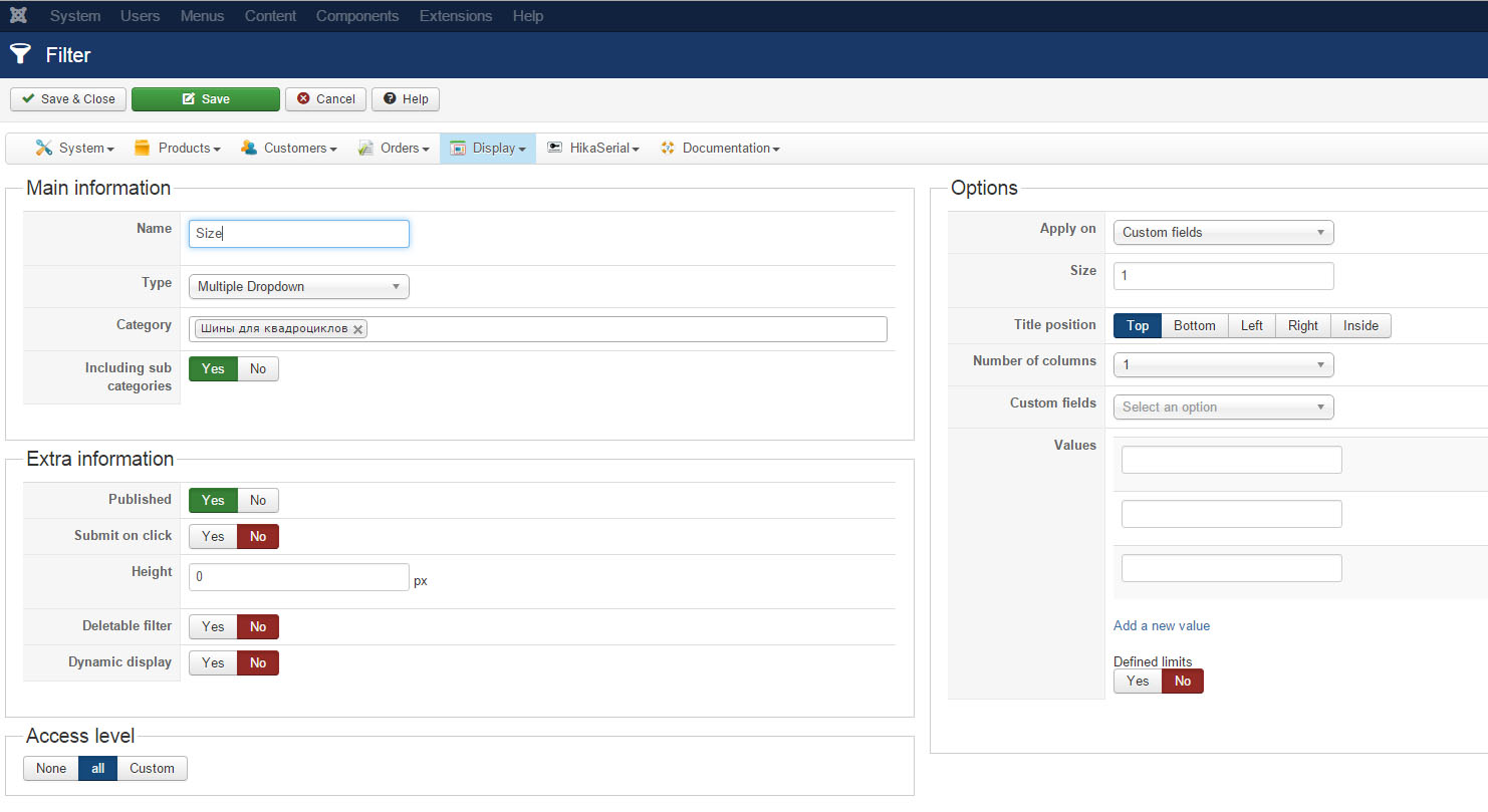

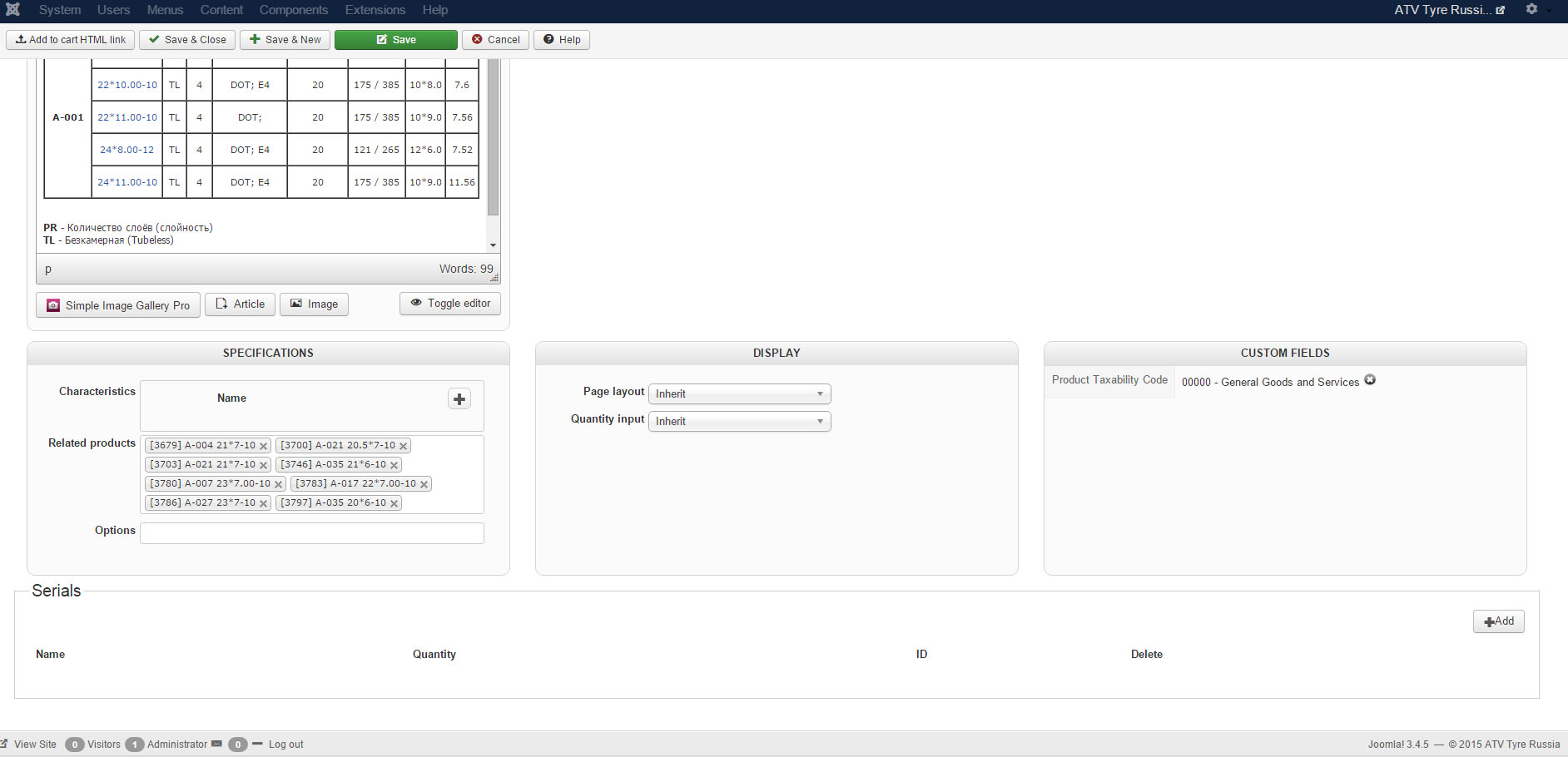

  • Posts: 12

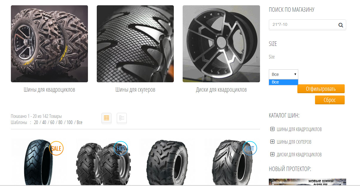

10 years 9 months ago #220455

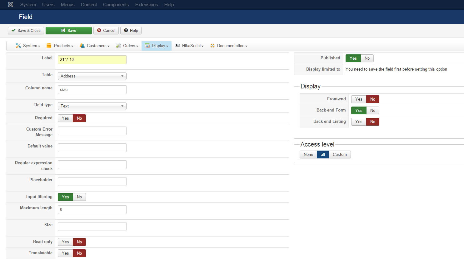

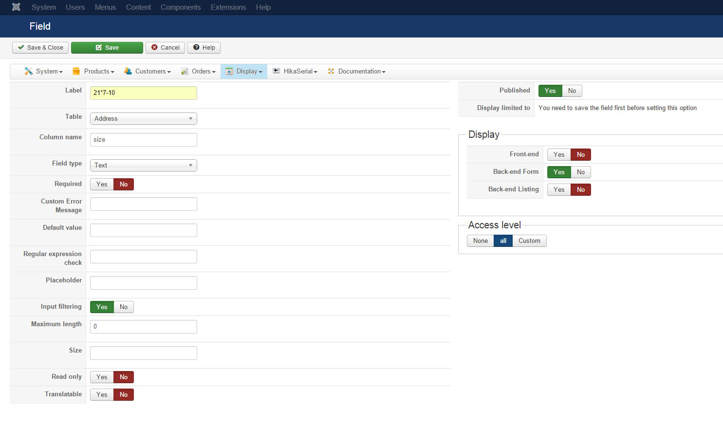

My way:
1. Create new custom field
2. Try to add custom field in page of products (how to do that?)
3. Create filter

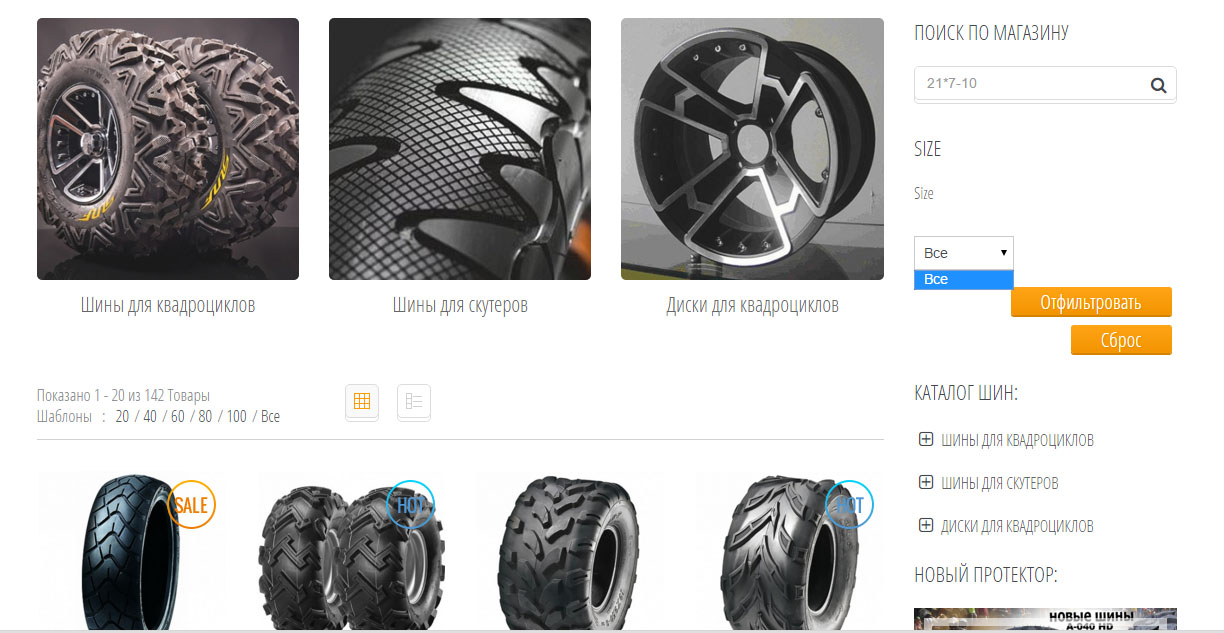

4. Create module (hikashop filter module)
You can see - atvtyre.ru/shop (right module) dropdown
Last edit: 10 years 9 months ago by sport.

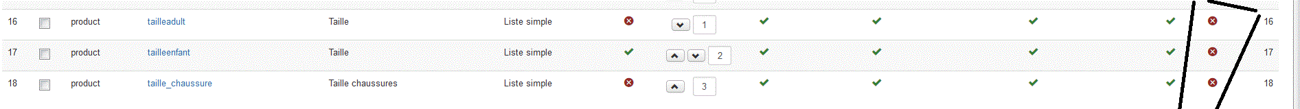

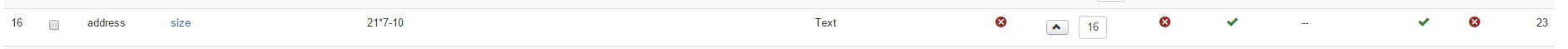

10 years 9 months ago #220462
You'll have to create a custom field from the "Product" table and not the "Address" table.
Also, you'll have to select your product custom field through the "Custom fields" option of your filter configuration page.

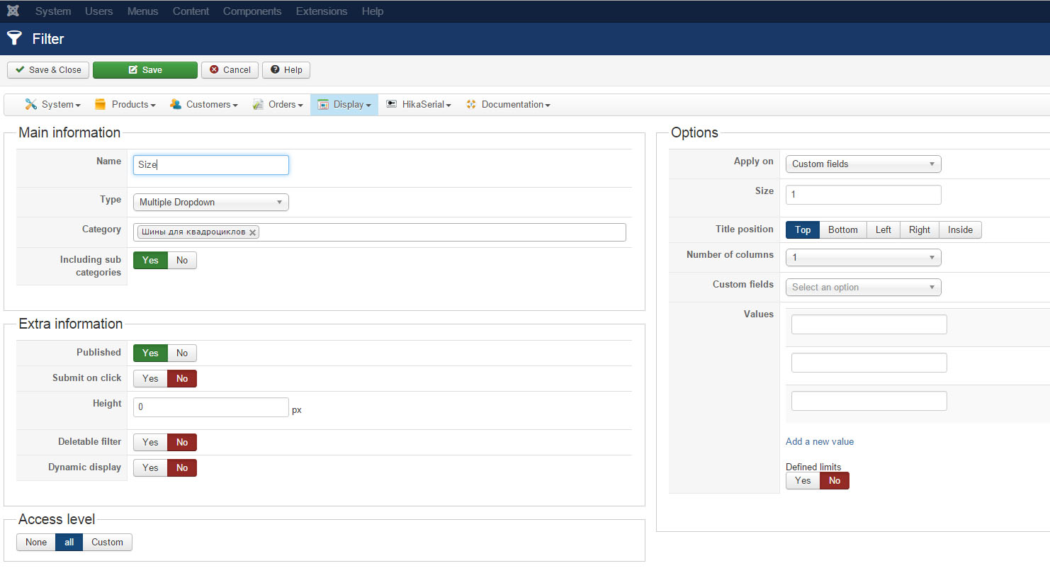

  • Posts: 40
10 years 9 months ago #220650

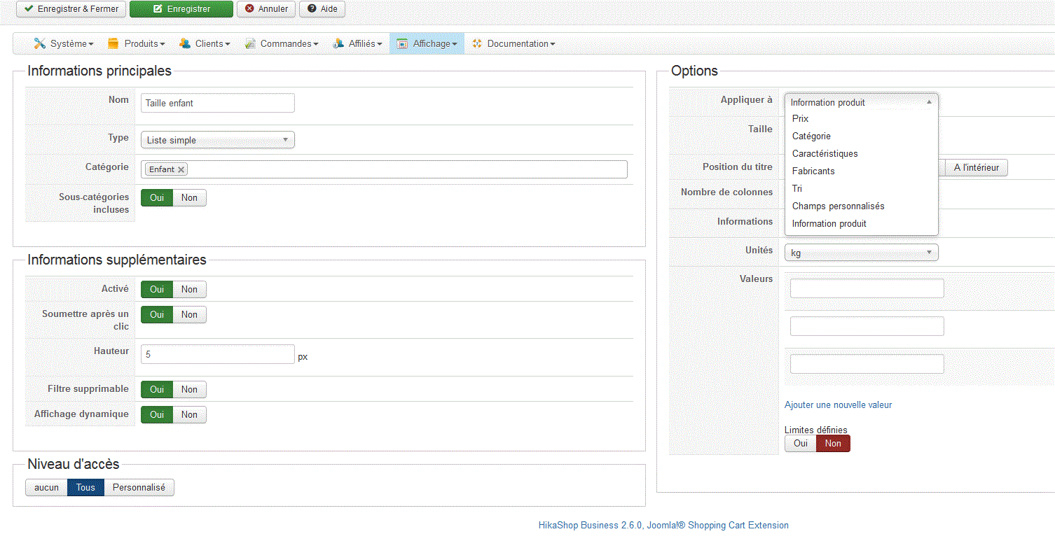

i have issue with size filter also
I created the custom shields but i dont have the choise on the filter.
Also, on the CORE column field is not activcated. Is this normal or something s wrong?
Last edit: 10 years 9 months ago by ioanna.
  • Posts: 40
10 years 9 months ago #220657
I found the anwser
I didn't select the custom fields in the options
Anyway, about the Core option not activate, is there something i have to do?

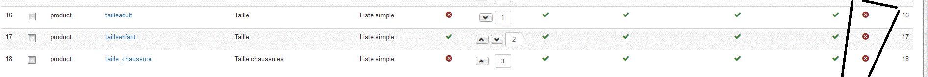

  • Posts: 86077
  • Thank you received: 14186
10 years 9 months ago #220731
There is nothing to do for that.
That's normal. It just means that this field isn't one of the "core" ones that are included by default with HikaShop (unlike the address fields).
