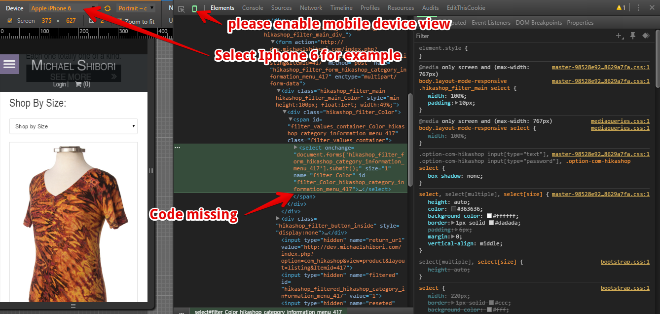

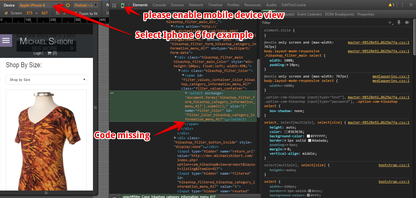

I would like to hide the select box on smartphones and display the div selection box, because it's looking better, but somehow the div box code is not generated on smartphones.

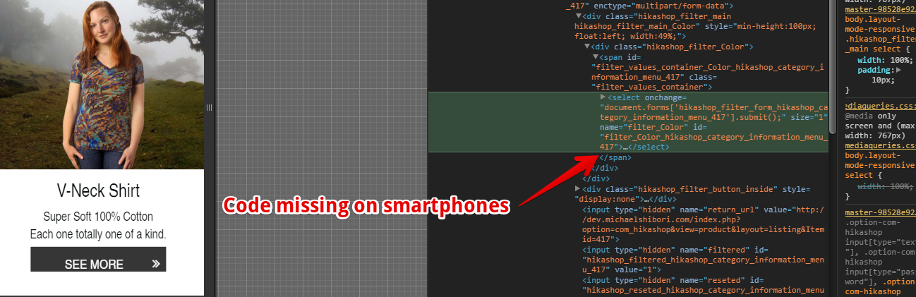

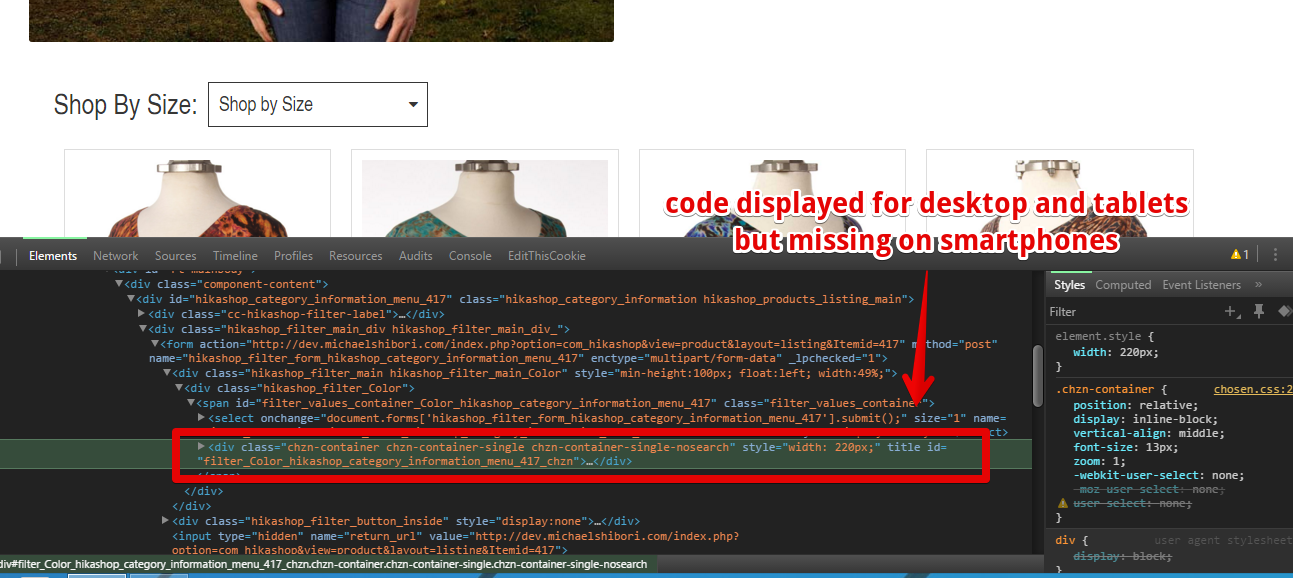

if you re-size the browser indeed the code is there, but if you change to Mobile Device View in Chrome browser you'll see that the code is missing and on my smartphone for example the select box is generated instead of the "chzn-container" div. Please see attachment.

10 years 8 months ago #222964
Chosen is a javascript library.
And that lib is not compatible with smartphones, so the lib is not activated when using a smartphone.
But there is no missing code ; no missing feature.
And it's not related to HikaShop.
