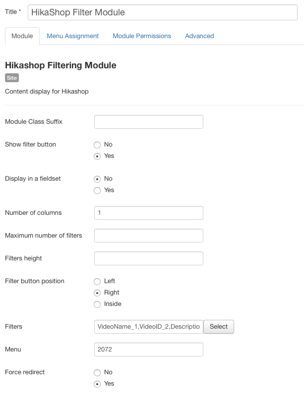

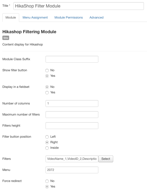

I suppose that you're using the filter module. You need to turn on the "force redirect" setting of the filter module so that the filter system redirects to a result page which by default displays all the products. In the menu item id setting of the filter module, you can enter the id of that product listing menu item so that the module redirects there when you use the filters.
You don't have to select all the categories in the filter itself.

I have a product list in my website which is "Business".
I use filter module. "fore redirect" is on and in Menu ID I added "business" product list ID (from menu). After that in "assignment menu" I just assigned "Business" product list menu and used this module there. But when I search for a product the result is the list of categories! and not product.

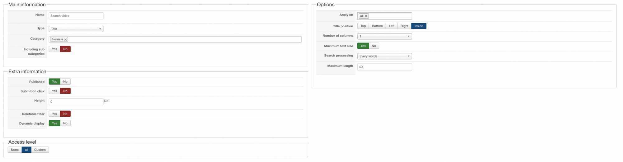

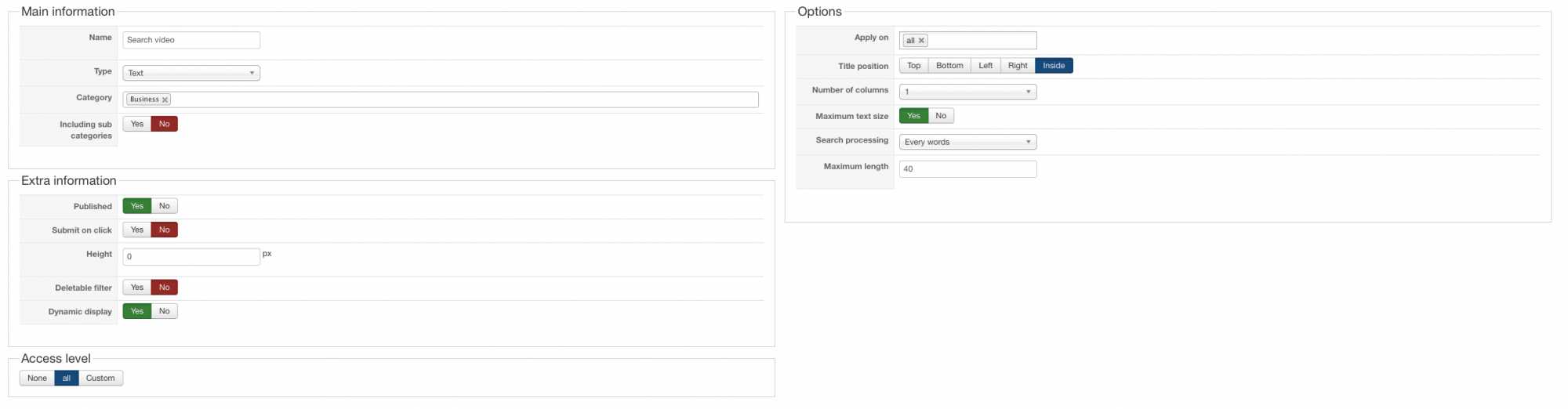

There must be an issue with the settings of your menu item.
Could you provide a screenshot of the products options and of the categories options tabs of your menu item ?

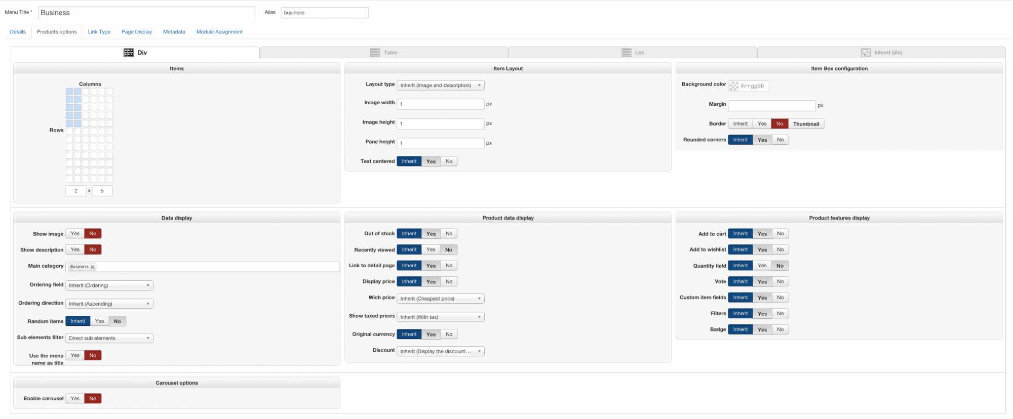

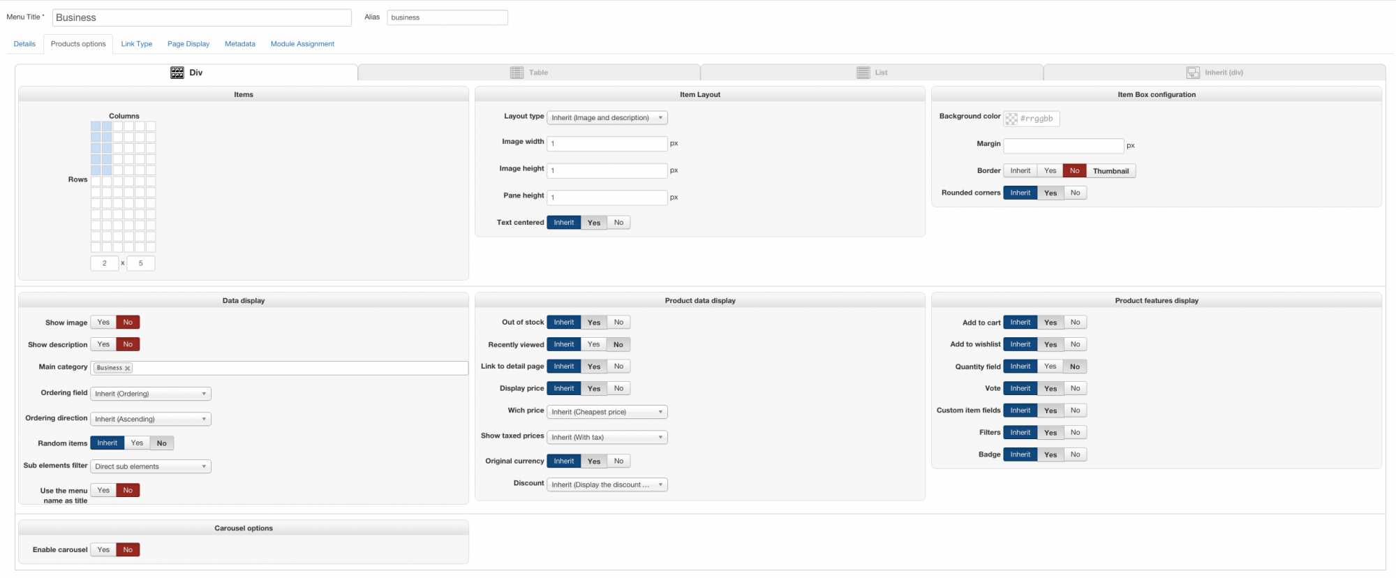

10 years 7 months ago #227076
Here is the screenshot from product list option (from menu).

10 years 7 months ago #227093
Your products listing menu item should list all the products. For that, the category selected should be the main product category and the sub element filter setting should be set to "all sub elements".
