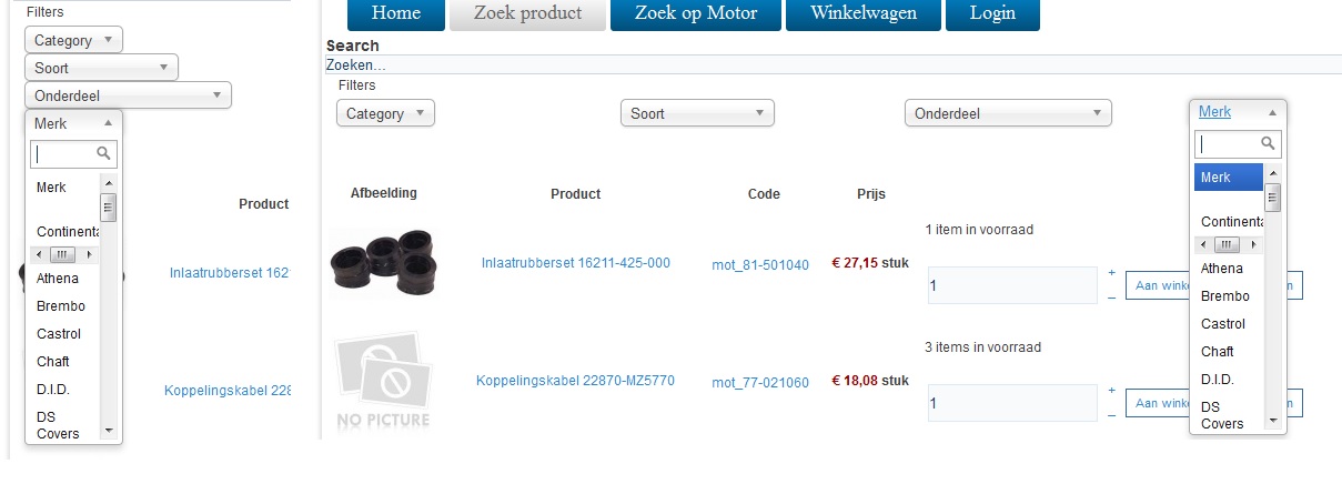

-- not sure if this should go in filters, or display category --
I created some filters on custom fields, and all looked just fine.
Now decided to add another filter on 'brand' field and the filter shows. However it is not adapting its size to the widest option in the filter option list, like the other thee filters..
Where did I go wrong ?
I can't recall setting width anywhere (and can't see where I could). It looks kinda anoying like this.
Placing the filters in 1 or 4 columns does not change the behaviour. The filter for 'brand' is not wide enough....
(Attached image has both views, 1 column and 4 columns)
10 years 7 months ago #226605
Your issue is related to the "chosen" javascript library and your template CSS rules.
There is nothing special to do in HikaShop ; you can see to deactivate the "chosen" setting in the HikaShop configuration in case where you have activated it.
  • Posts: 62
10 years 7 months ago #226714
I can't recall having done anything special to CSS, so don't understand the answer at this point.
In the HikaShop configuration the CSS is set to default.
So I don't see why filtering field of custom objects adapts it's width to the widest element in the list to choose from, and the filtereing field of standard product field 'brands' does not.
10 years 7 months ago #226727
Please read my previous message carefully.
www.hikashop.com/support/support/documen...html#display_general
  • Posts: 62
10 years 7 months ago #226778
I don't understand that message then..... (probably my bad)
"you can see to deactivate the "chosen" setting in the HikaShop configuration"
Where can I do that ?
The link points to the image settings, but I don't have issues with an image, but with the field width of the filter itself.
It does not adapt (correctly) to the width of the fields that it shows causing a slider bar to appear inside the options listed in the filter....
10 years 7 months ago #226792
You can do that in the HikaShop configuration !
And I also gave you a link to the HikaShop configuration documentation page for the exact right part that you're looking for...
Please understand that your dropdowns are not regular dropdowns but are managed by a javascript library.
We are not responsible of the display issues of that library which is provided by Joomla itself.
The following user(s) said Thank You: storeitonline
  • Posts: 62
10 years 7 months ago #226914
Thanks very much, I understand it now.
