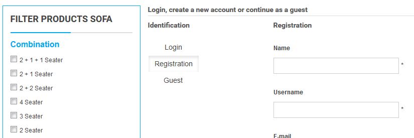

using the mod_hikashop_filter how can I dymanically remove the filter from the screen when the "Registration" or "Guest" button is selected at checkout?
regards,
C
  • Posts: 86077
  • Thank you received: 14186
10 years 6 months ago #230650
First, enter the id of a menu item of the type HikaShop checkout in the "force a menu on checkout" setting of the HikaShop configuration. Then, edit your module via the Joomla modules manager and in the assignement tab, remove that menu item so that the module doesn't display on that menu item.
