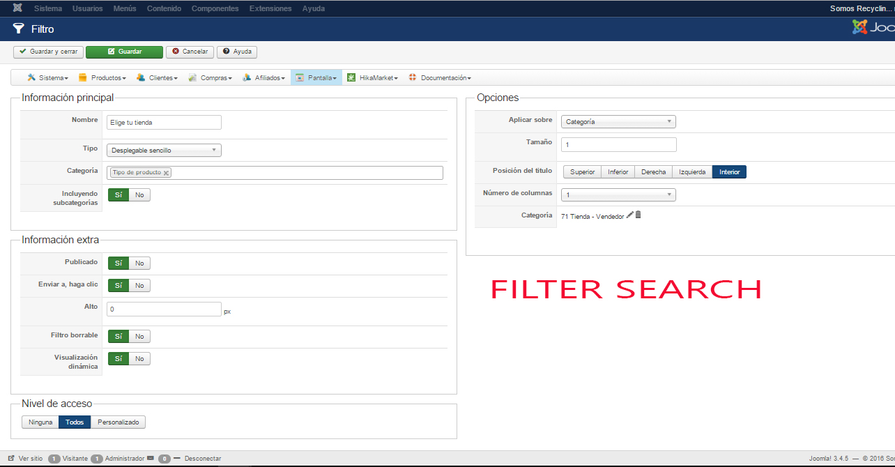

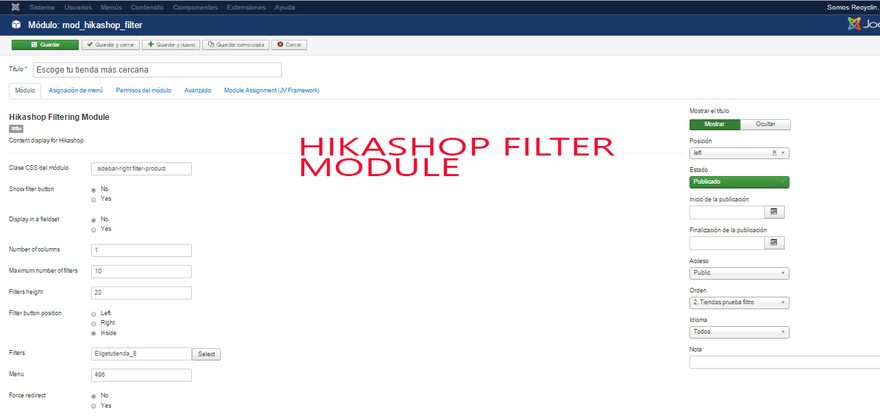

I need that different filters of search run "simultaneously " to specify better the product: Shop/vendor, kind of product, brand... that can be visualized in the "Catalago" menu or "Product Listing.

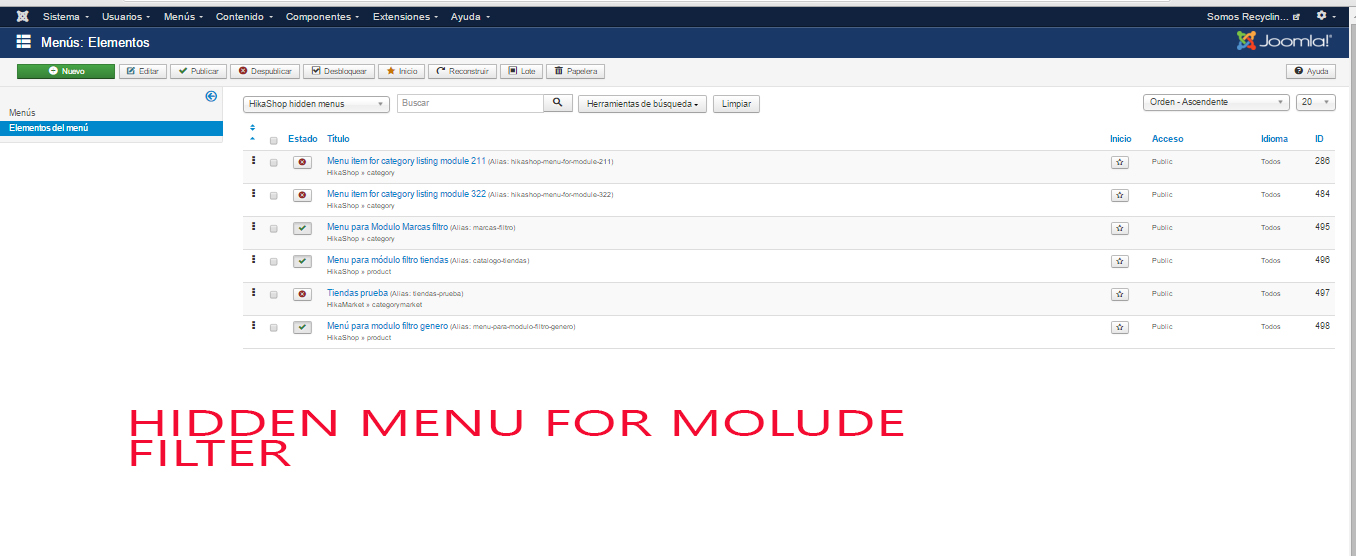

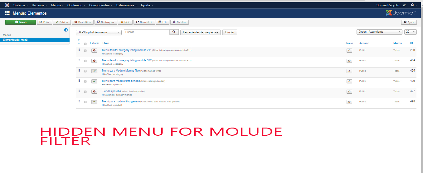

I had done:

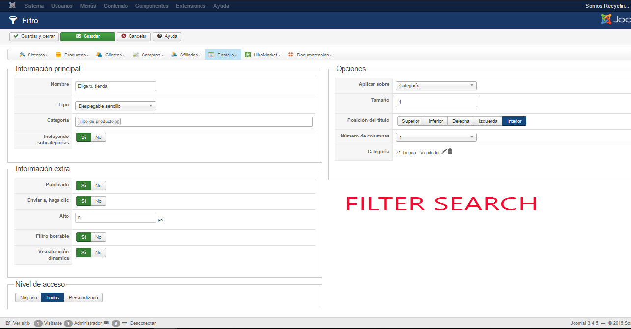

1. I created a filter for every category or personalized fields,

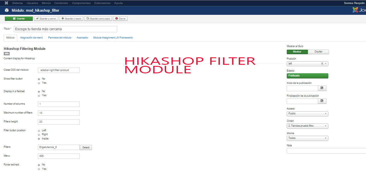

2.Later, I created a module in joomla of "hikashop filter " and it to associate to Product Listing's menu in Hikashop Joomla's hidden menu.

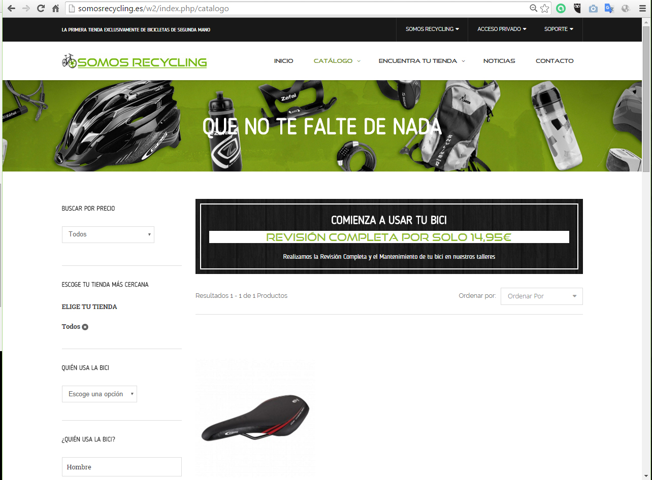

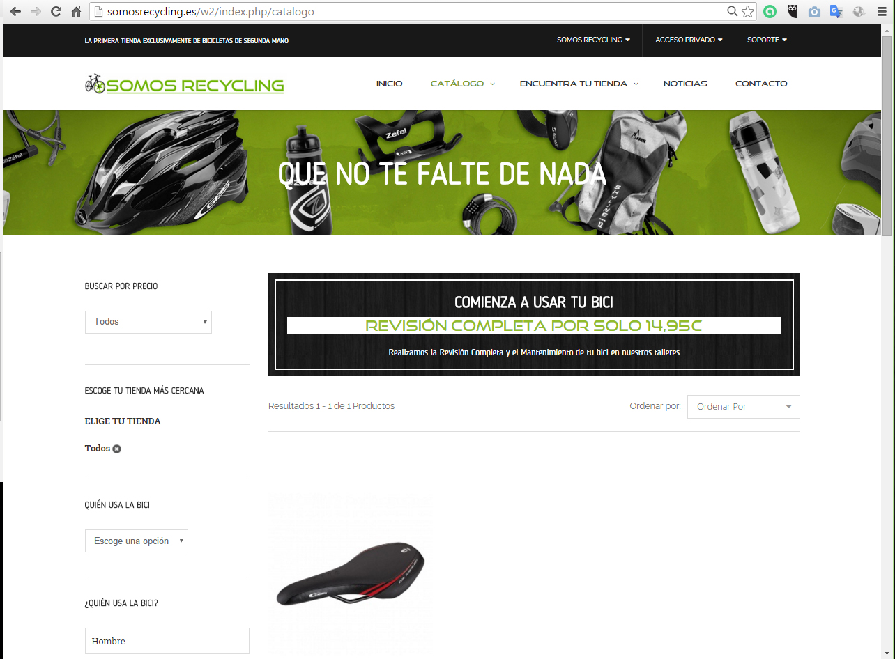

The results are not the awaited ones because:
1. Whenever I search for a filter I annul my previous filters.
2. The search is not realized for I filter correctly.
Please, that I must do?
If you need more information, you question without problems
Thank you in advance.
  • Posts: 86077
  • Thank you received: 14186
10 years 5 months ago #231595
The issue is that you have different filter modules for each filter.
You should have all the filters displayed on the page in one module (with the 'Filters' setting of the module where you would select several of them).
That way, they would work together like you want.
